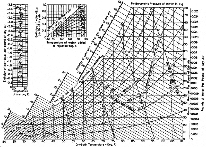

I did some research on how dehumidifiers work and from what've been able to find out, it takes in room-temperature air, cools it, thus condensation, then runs it back through heated coils so bring the air back to room temperature.
I got around to taking apart an actual dehumidifier it's pretty much as expected. The only thing that was actually different from my little bit of research was that the air was heated up first and then cooled down rather than vice versa. So the condensation process goes from warm to cool, rather than room-temperature to cool. Would this increased temperature difference make condensation more effective even though the source of the air is the same? Or would warming up the air first dry some of the moisture out?
It doesn't make sense.
To dehumidify, you neet to cool the air until dew point. Further cooling will not cool the air but will condensate humidity. Afterwards, you need to warm the air up to room temperature.
If warming comes first, you'll never get condensation.
By the way, wrming was done with electric resistance or was it using the hot part of the cooling machine?
Well, it wouldn't be done with electric resistance, it woudl be the warm refrigerant. But I always thought the airstreams were separated and that the cool plates just absorbed water via convection/vapor pressure.
This doesn't make any sense to me either. What part of the machine is indicating to you the direction of airflow?
Looking at the psych. chart its pretty easy to see that if you heat the incoming air, then cool, without heating it again, your just wasting energy. Unless I'm completely missing something.
