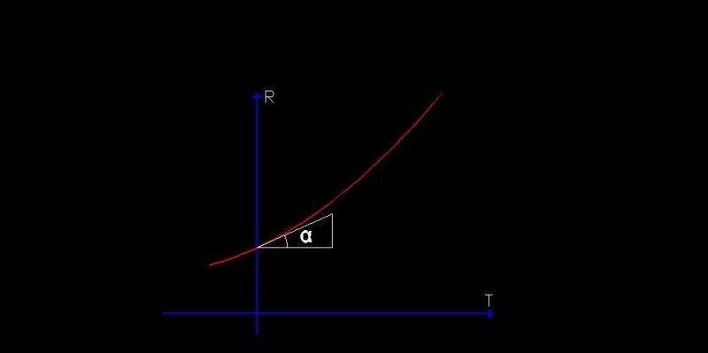

The book says the formula is accurate as long as t and α are small. i understand about t but why also α?
Resistance R: ##R=R_0(1+\alpha t)##
According to the graph (see picture) α is the slope and is suited for every material, so only t makes a difference, because of the limited linear approximation
  • Graph of resistance R against temperature T, showing a red upward-curving curve. A tangent triangle at the intercept is labelled with the angle alpha, indicating the slope of the curve at that point.
I agree with you. We could expand the approximation to more terms to make it more accurate: ##R=R_0(1+\alpha t + \beta t^2 + ...)##. The approximation ## R=R_0(1+\alpha t)## is reasonable if t is small and ##\beta## not large; it has nothing to do with ##\alpha##.
