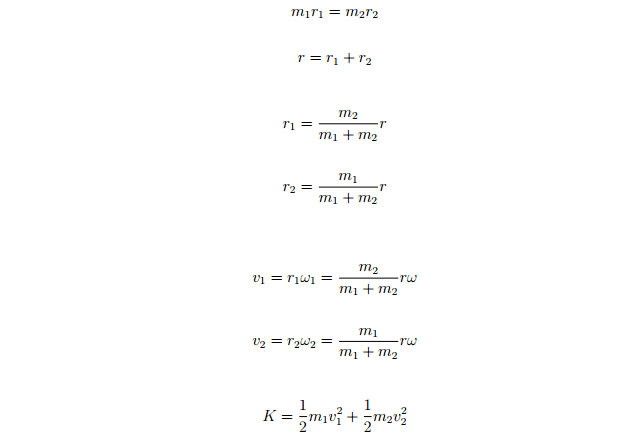

I am trying to get the hamiltonain operator equality for a rigid rotor. But I don't get it. Please see the red text in the bottom for my direct problem. The rest is just the derivation I used from classical mechanics.
Handwritten-style typeset derivation of a two-body rigid rotor: m1r1 = m2r2, r = r1 + r2, r1 = m2/(m1+m2) r, r2 = m1/(m1+m2) r, v1 = r1 w1 = m2/(m1+m2) r w, v2 = r2 w2 = m1/(m1+m2) r w, K = 1/2 m1 v1^2 + 1/2 m2 v2^2.
By using algebra we obtain:
Typeset derivation: K = (1/2) p_mu^2 / mu, where p_mu = mu v, and mu = m1 m2 / (m1 + m2) is the reduced mass.
By using this definition K of rotational kinetic energy one writes:
Equation (6.45): H-hat = P-hat_mu squared over 2 mu = minus h-bar squared over 2 mu times nabla squared, with mu = m1 m2 over (m1 + m2).
Red handwritten-style equations: p_μ²/2μ = ħ²ν²/2μ = ħ²k²/2μ = p²/2μ, followed by the note p_μ² = μ²v² ≠ p²?
[/B]
You can show that
$$K = \frac 12 \mu (r\omega)^2 = \frac 12 (\mu r^2)\omega^2 = \frac 12 I \omega^2 = \frac{L^2}{2I},$$ where ##L## is the angular momentum of the system.
