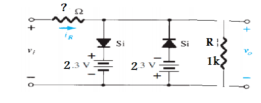

I knew that we will put a two diodes( with a dc battery {2.3 V} series) parallel to each other in opposite directions .. but what meant by gain is 0.95 ?
Hassan Raafat said:
Clippers equations
It means that the voltage divider that you form with your series resistor and the load resistor should not drop more than 5% of the input voltage when the diodes are not conducting. Can you show us your solution circuit now? :smile:

Hassan Raafat said:
Good! Now you just have to calculate the input resistor value so that the output voltage is 0.95 * Vin...
Camera is not good , I can't upload complete solution but R has a value R=52.63
Can you show your equations that you used to calculate this value? It looks about right, but it would be good to see how you got it. Just type it in here... Thanks.

Yeah, the pictures are not showing up. Can you just type it with text into the forum window?
Vout = ( 1k / (1k+R) ) * Vin
Vout / Vin = 1k / (1k+R)
0.95 = 1000 / (1000+R)
R = 52.63 ohm

Great! :smile:

Oh, that wasn't part of what you posted in Post #1. The output waveform will just be a clipped version (and 95% of) the input waveform. What kind of input waveform are you supposed to use? Sine wave? Ramp?
sine wave
Hassan Raafat said:
sine wave
Of what amplitude? You should be able to draw the input and output waveforms...
that means that the output will be a sine wave with a peak equals (100/95) * 3 , right ?
Not exactly. The gain Vo/Vi = 0.95, and the Vo waveform clips at +/-3V.

You draw the input sine wave with some amplitude (say, +/- 5V), and then draw the output waveform which is 0.95 as big, and is clipped at +/- 3V.
One way to do it is in Excel, but you can do it by hand as well. What is the exact wording of that part of this homework problem?

You don't need to know much about input Vin. If Vin at any moment exceeds the circuit's clipping level then the output waveform will be clipped, and at those times when Vin does not reach the circuit's clipping level then there will be no clipping of the waveform.
Vin can be any waveform and the clipper will still operate. It is often convenient to illustrate the operation of a clipper using a sinewave, but you could use a triangular wave, or even random noise.
Your assignment asks you to use a sinewave input. Just choose its amplitude to be whatever is needed to produce some clipping, and sketch what the corresponding output will look like.
