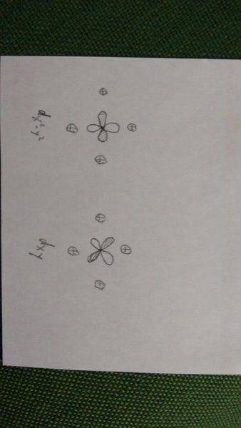

In atoms in the gas phase, you can observe this alignment. However, in condensed matter, electrons get reflected by other atoms, so the expectation value of angular momentum vanishes. In crystal field theory you can show that e.g. none of the orbitals from the ##E_g## or ##T_{2g}## set carries angular momentum.
Here some example:
Consider a single electron on an atom in a d-shell. Among others, it can be in ##d_2## and ##d_{-2}## orbitals which are energetically degenerate in the absence of a magnetic field and carry magnetic momenta of ##m_z=\pm \hbar \mu##.
In the absence of a magnetic field, we can as well form the two real functions ##d_{x^2-y^2}=d_2+d_{-2}## and ##d_{xy}=(d_2-d_{-2})/i##. But in the solid state or in a molecule where each atom is surrounded quadratically by 4 ligands with positive charges, the degeneracy will be lifted and the ##d_{x^2-y^2}## orbital will be lower than the ##d_{xy}## orbital as its lobes point in the direction of the positive charges. When these states are brought into a magnetic field, they will admix only very little of the other wavefunction and the paramagnetism will vanish. This is what is called quenching and how it is related to ligand field theory, see also this scetch here:
Likes Charles Link
