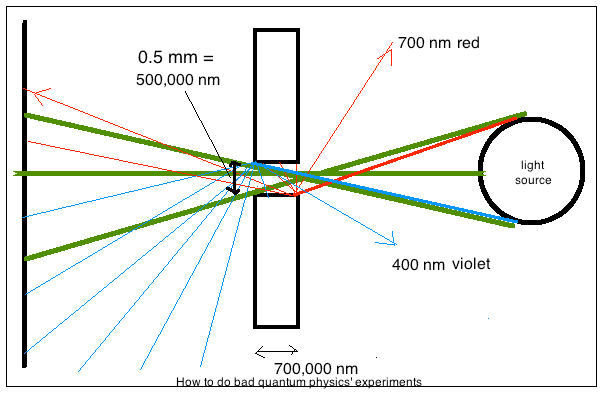

I watched a bucket load of instructional videos on the topic, last night: Interference of electromagnetic waves [khanacademy.org]
I even watched an instructional video, before this thread even started!: Lec 34: Heisenberg's Uncertainty Principle | 8.01 Classical Mechanics, Fall 1999 (Walter Lewin)
So today, I made some measurements, made a doodle, and decided, that I have a great admiration, for real scientists.
