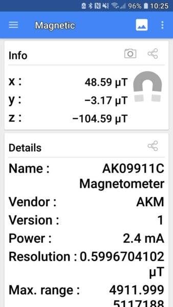

Here is a screen shot from my phone's magnetometer.

Here is a 3 axis chip used in mobile phones. https://www.akm.com/akm/en/product/detail/0059/
For 3 axes, I presume there are 3 sets of sensors.

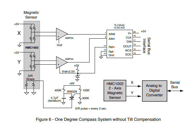

Honeywell application note
https://aerospace.honeywell.com/en/~/media/aerospace/files/technical-articles/applicationsofmagnetoresistivesensorsinnavigationsystems_ta.pdf
Likes dlgoff
Very nice Jim. Thanks. I've never really looked into magnetoresistive (MR) sensors before. :thumbup:

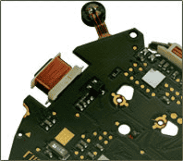

@jim hardy i had the same question, is it mechanical or electrical? and why there are 2 rectangular coils? Maybe the drive and sense coils? And why they are separated in the picture?
Maybe they are not using fluxgate (and it seems that it isn't magnetoresistence as well), maybe is some other technology developed by themselves...
i too was confused,
because two coils suggests a fluxgate but i couldn't see the toroid core for one in that Casio picture.
and the Honeywell appnote doesn't need coils for a magetoresistive compass
so I'm not sure what Casio has done.

And looks like the 2 coils are separated. Aren't they those two cooper colored rectangles in the picture?
Of course they are rotated 90° from each other. The direction of the magnetic field is found by both the polarity of the sensed voltage and their relative amplitudes. If there was only one coil you would get no signal at all when it is oriented East-West, and to find North you would have to rotate the watch while looking for maximum signal strength. This way the watch does all the work!
Cheers,
Tom
In your explanation, are you considering they work as fluxgate? Because from what I got reading about it, it doesn't have to be 90 degrees from each other. The coils should be one on top of the other, I guess...
True, they do not have to be mounted 90° from each other; the important thing is they are oriented 90° to each other. The fact that Casio mounted them 90° around the periphery of the watch was very likely a mechanical consideration. If they placed the coils on top of each other the watch would have to be thicker to accommodate them.
Cheers,
Tom
