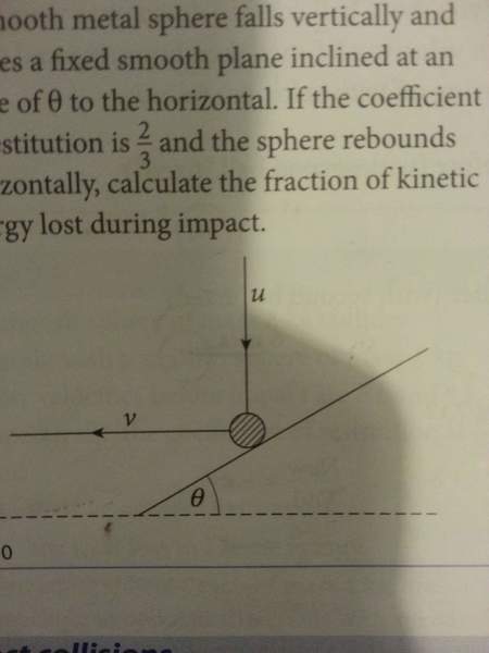

A smooth sphere falls vertically and strikes a fixed smooth plane inclined at an angle of ∅ to the horizontal.If the coefficient of restitution is (2/3) and the sphere rebounds horizontally,
Its speed before impact is u and after impact v
calculate the fraction of kinetic energy lost during impact.
Diagram of the question is attached to this post.
i = horizontal component vector and j = vertical component vector
Taking the inclined plane as the x-axis
v, vcos∅i + vsin∅j ... alternate angle to inclined angle
u, vcos(90 - ∅ )i - v sin(90 - ∅)j = usin∅i - ucos∅jthe I component remains the same
vcos∅ = usin∅
v = utan∅
vsin∅/(ucos∅) = 2/3 (v/u)tan∅ = 2/3 (utan∅/u)tan∅ =2/3
(tan∅)^2 = 2/3 tan∅ = (√6)/3v = u(√6)/3
.5mu^2 - .5mv^2 = energy loss
.5mu^2 -.5m(6/9)u^2 = .5mu^2 - m(6/18)u^2 = .5mu^2 - (1/3)mu^2 = (1/6)mu^2
fraction of kinetic energy lost is 1/6my book says the answer is 1/3 but I got 1/6. Any help would be appreciated.

Woolyabyss said:
vcos∅ = usin∅
v = utan∅
Correct so far
It is a bit convoluted there. I can't follow what you have done. Just use:
vsin∅/(ucos∅) = 2/3
so: tan∅ = 2/3(u/v)
Since you also have tan∅ = v/u
∴ v^2/u^2 = 2/3
AM
I used the equation
v^2/u^2 = 2/3
v^2 = (2/3)u^2
so .5mu^2 - .5m(2/3)u^2 = 1/6mu^2
fraction of kinetic energy lost during impact = 1/6
I got the same answer do you think my book could be wrong?
What fraction is 1/6mu^2 of .5mu^2?
1/3! thanks
