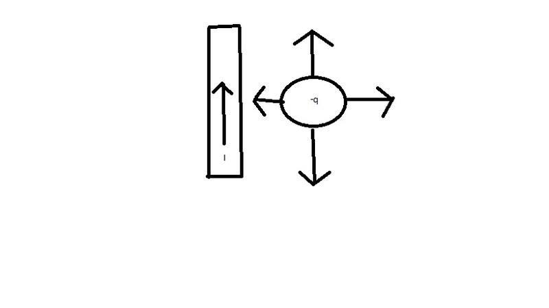

2. A negative point charge moves with a velocity v next to a long, straight wire carrying a current I upward (in the plane of the page. Because of the charge's motion, there exists a force on the charge to the left. The charge must be moving:
A. to the left B. to the right C. upward D. downward E. out of the page

For question 2, we're told that the moving charge is negative but that the current moves in an upward direction. I was thinking that a moving charge with a given velocity would be equivalent to current if the charge is positive. Since we're told that the point charge is negative, I rationalized that it must be moving in an opposite direction to the current and hence, would be moving in a downward direction, so answer D.

yeah, I agree with your answer to question 1. And your answer to question 2 looks right. Although I can't be sure, because I'm not certain about how to imagine where the negatively charged particle is (relative to the wire). On the paper, I guess the wire is drawn as a vertical line, and the current is moving towards the top of the page? And on the paper, where is the negatively charged particle drawn? Is it to the left of the wire or the right of the wire?
I agree with question 1.
Question 2:
Indeterminate! Depends on where the charge is located along the wire.
If it's to the right of the wire it's moving in the downward direction.
If it's to the left of the wire then it's moving upward.
Thank you both for your input! Sorry didn't draw out the picture, I've attached it to this post! It looks like it's to the right of the wire so since the force is to the left of the charge, it would be moving downward then?
Correct.
One way to confirm this:
F = qv x B
Using unit vectors i,j,k only, since we're interested in direction only, not magnitudes,
-i = (-1)ζ x -k
where ζ is the unknown unit vector for v
So -i = -ζ x -k
the solution for which is ζ = -j.
