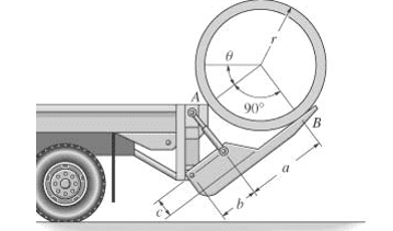

The 4000N concrete pipe is being lowered from the truck bed when it is in the position shown:
If the coefficient of static friction at the points of support A and B is 0.4, determine where it begins to slip first: at A or B or both at A and B
It's not so complicated task.
ΣFx = 0 = Na+Fb - Wsinθ
ΣFy = 0 = Nb+Fa - Wcosθ
ΣMo = 0 = Fbr - Far = 0
Fmax=μNmax
[/B]
The question I have is why the friction at support A have the direction with montion of the pipe and not trying to oppose the motion. We assume that the pipe is moving clockwise direction according to our friction direction at support B. Can someone explain me this ?

First, it's important to understand the mechanism on the truck. There is a gate, the upper end of which is at B. The hinge is at the bottom, vertically below A. A telescopic arm angling down to the right from A extends to lower the gate. As it does so, A and B get further apart. That is why the cylinder must slip at one or other, or both, of those two places.
So it may help to consider a simpler version. A horizontal plank length L rests on two supports. The supports are distances X, Y from the ends of the plank respectively. The supports are being pushed further apart. The plank must slip on one or both supports, but it will not slip the same way on both. The right hand support is going to the right, so the frictional force on the plank is to the right. Conversely, the frictional force on the plank from the left hand support is to the left

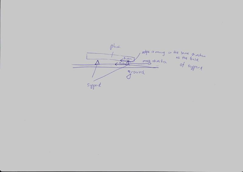

Okay I understand what you want to say. But the problem is that for me:
If the support from right hand going to right then the friction is to the left... And when the support from left side going to left the friction is to the right. Why you saying something totally diffrent?
It's to the left on the support but it's to the right on the plank.
Totally don't understand that...and I'm confused...
That's what I see. Looks like I don't understand the concept...
Do you agree that the frictional force on the support is to the left? It opposes the attempted motion of the support relative to the plank, yes?
When friction occurs at an interface, it is always as a pair of equal and opposite forces, action and reaction. It is one way on one body and the other way on the other body.
As far as the plank is concerned, friction from the support is trying to drag it to the right.
To look at it another way, without friction, the plank would move left relative to the support. Since friction opposes relative motion of the surfaces in contact, it acts to the right on the plank.

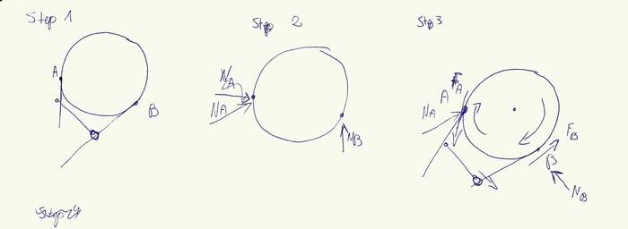

I study our conversation and I decided to clarify that bothers me here. And I will show step by step what the problem for me is.
Step 1 :
Is just recognize two point of contact on the pipe. And as you mentioned the hydraulic mechanism that make those two 2 points further away from each other.
Step 2:
We have normal force from the point of support at A and B normal to the surface. Nothing extraordinary for me.
Step 3:
This where this madness begin. In my workflow I assumed that when the hydraulic mechanism trying to get the pipe down and obviously change the distance between those 2 supports. Then the friction will occur to prevent the rotation of the pipe. If we assume the clockwise direction (we don't know if it's right). Then friction will trying to block the slipping by acting to right side (with angle of course, but not important right now). And the same will be for the point A the pipe will try to rotate at point A and friction will be trying to stop it by acting downard. So actually the problem for me is that even with this plank I can't imagine this situation for the pipe.
Like you said that this pipe try to rotate counterclockwise at A and clockwise at B in the same time.
Your mistake here is in thinking of the pipe's rotation independently of the movement of the mechanism. Certainly if the mechanism were fixed and something else were twisting the pipe then the two frictions would act in the same sense, clockwise or anticlockwise. In the plank case, it is like taking the supports to be fixed and noting that the friction must act on the plank ro the left at both or to the right at both.
But in this problem you need to consider the two possible rotations in relation to the movement of the mechanism:
1. There is no slip at point A. The slip at B will be clockwise relative to the mechanism; or
2. There is no slip at point B. The slip at A will be anticlockwise relative to the mechanism.
