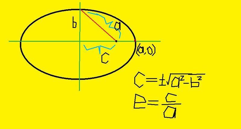

Hey what is the directrix when talking about an ellipse?
I found a book that finally shed light on what eccentricity was, but there's still no mention of what the directrix is.
To be honest, it doesn't even explain eccentricity but I intuitively understand it, however the directrix is something that I don't understand with reference to an ellipse, nor how to find it nor why anybody wants to.
Perhaps you could shed some light on how to go about finding it.
  • Hand-drawn diagram of an ellipse centred at the origin on green x and y axes, with semi-axes a and b marked, a point (a, 0) labelled, and c marked from the centre to a focus; below are the formulas c = ±√(a² − b²) and e = c/a.

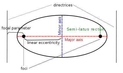

If I am not mistaken, the directrix is not drawn in that figure. This might help.
  • Diagram of an ellipse labelled with its major axis (red dashed), minor axis (blue dashed), foci, linear eccentricity, focal parameter, semi-latus rectum (green) and two vertical directrix lines outside the ellipse.
Thanks, I know what the directrix is it's just that I don't know how to calculate it given an equation (nor why you'd even want to). I don't see the relationship to anything discussed when talking about ellipses (maybe why It took me so long to even see it in a book).
Take an equation;
[tex]\frac{x^2}{9} \ + \frac{y^2}{16} \ = \ 1[/tex]
I calculate the focus(es) to be;
c = ±√(a² - b²) = ±√(16 - 9) = ±√7
Where a is the semi-major axis (4²) and b is the semi-minor axis (3²) here.
The eccentricity to be;
e = c/a = (√7)/4
But how do I calculate the directrix, and why would I want to?
That's all I'd really like to know, if anybody knows why please let me know.
thanks :)
For an ellipse the equation of directrix is given by x=± a/e. It's been a while since I've studied them and its late here so I have to go to bed now :). I'll revise my course tomorrow and try to find out the answer to that tomorrow.
Meanwhile this might help.
"The directrix of a conic section is the line which, together with the point known as the focus, serves to define a conic section as the locus of points whose distance from the focus is proportional to the horizontal distance from the directrix, with r being the constant of proportionality. If the ratio r=1, the conic is a parabola, if r<1, it is an ellipse, and if r>1, it is a hyperbola"
