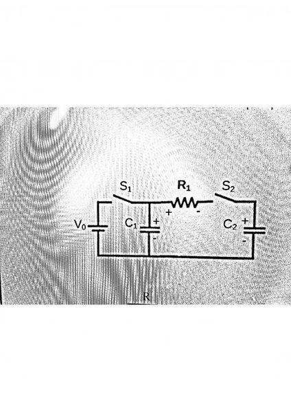

Given v0 c1c2 r1 need to find the current on r1 picture
Circuit schematic: battery V0 with switch S1, capacitor C1 in parallel with the battery branch, resistor R1 and switch S2 in series, and capacitor C2 on the right with +/- polarity marked, all on a single loop.
switch 1 is closed for long time and on t=0 opened and switch 2 is closed
in the attached file

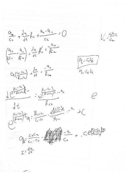

Handwritten derivation solving a first-order RC circuit charge equation, with equations for q over C1, dq/dt, R1C1 and R2C2, and an integrating-factor step leading to q(t) with a constant C.
i was trying to use kvl assuming that q0(charge on cap before opening switch 1) is v0 adn the sum of q1 and q2 (the charge after switch 2 is closed) is equal to q0
how to find cons c and I(t)?
Usually one uses known boundary conditions (initial, steady state) to solve for the unknown constants, plugging the known conditions into the general solution of the differential equation.
For this problem it might be easier to just look at the initial and final conditions and "connect" them with the known behavior of an RC circuit. That is, if you can determine the initial current that flows the instant after the switch S2 is closed and the final current at steady state, you know that the current must follow an exponential decay between those states. You've already determined the time constant, so the rest will be straight forward.
