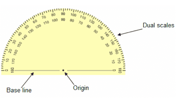

so its 144degrees off the starting point? so like N54E? or N144E if from Starting point
I'm not sure of the standard way to express the point in N/E notiation, but it would be at the 144 degree mark on the outer scale of the figure below, that starts at 0 at the left, and progresses up to 180 degrees clockwise...
http://www.mathstips.com/wp-content/uploads/2014/01/measure-angle.png
Protractor with dual scales, a base line with 0 and 180 at the ends, a marked origin at the centre, and arrows labelling the base line, origin and dual scales.
  • Protractor with dual scales, a base line with 0 and 180 at the ends, a marked origin at the centre, and arrows labelling the base line, origin and dual scales.
