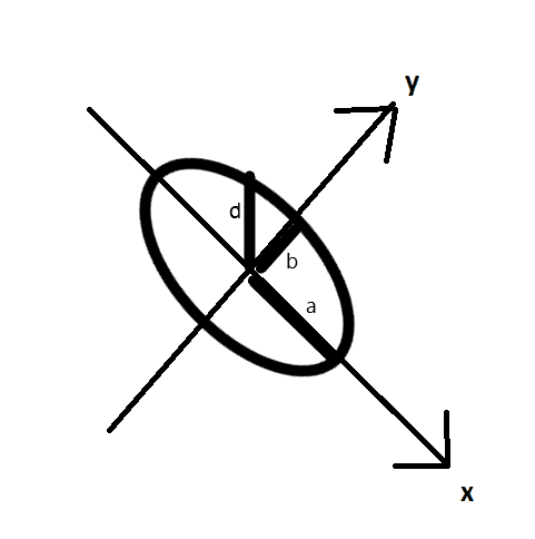

I thought it would be easier for Alice to throw a sphere (with radius ##R##) instead of a crate, that fits through the window, with speed ##\frac{c}{\sqrt{2}}## at 45°. But now I am not sure.
Hand-drawn diagram of an ellipse centred at the origin of crossed x and y axes tilted 45 degrees, with labelled segments a along the major axis, b along the minor axis and d from the origin to the ellipse edge.
By length contraction it becomes an ellipsoid:
##a=R##
##b=R/\gamma(\frac{c}{\sqrt{2}}) = R \frac{\sqrt{2}}{2}##.
##x(\varphi) = R \cos(\varphi)##
##y(\varphi) = R \frac{\sqrt{2}}{2} \sin(\varphi)##
##d = \sqrt{x(135°)^2+y(135°)^2}=R \frac{\sqrt{3}}{2}##
The result for d has the vertical component of the length contraction of the sphere, which fits to the length contraction factor of the window, moving at ##\frac{c}{2}##. But this cannot go through the window, because in the ground frame, the sphere must touch the "South" edge of the window earlier than the "North" edge. Reason: Relativity of simultaneity.
My conclusion would be, that Alice is in this case not allowed to use a 45° angle.
Am I correct?
Sagittarius A-Star said:
I thought it would be easier for Alice to throw a sphere (with radius R) instead of a crate, that fits through the window, with speed c2 at 45°. But now I am not sure.
Look at it in the train frame. If it can fit in the train frame then it can fit in the ground frame too. Just describe it fully in the train frame and then transform to the ground frame.
In the train frame it must fit through the window. Then there must be an error in my calculation.
You have an arithmetic error here somewhere. Considering that ##R/\sqrt{2} < R##, it follows that
