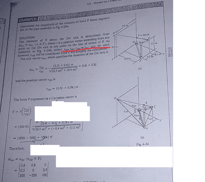

In this note , I was told that either vector OD , OC , AD and AC can be used as the distance between the Force and OA axis ... why ? To produce moment , the distance r must be originate from the origin of force ( point C ) , am i right ? So , IMO, only r AC can be used...

Note the presence of the cross product when calculating the moment. Would any of those choices give a different result?
Sorry, I still don't understand. Can you explain further?
Realize that when you take the cross product ##\vec{r} \times \vec{F}##, where ##\vec{r}## is a vector starting at pt O and extending anywhere along the line of ##\vec{F}##, that you get the same answer. Essentially you are finding the perpendicular distance between pt O and the line.
In simpler terms: r X F = r sinθ F. Realize that when r changes, θ also changes so that r sinθ remains the same. Play around with this until you get it.
from the figure , it show that the vector r _OD is not along the vector F ...
By saying ##\vec{r}## is a vector starting at pt O and extending anywhere along the line of ##\vec{F}## , do you mean like this ? the r can be any vector ( in different colours ) along the vector F ?

Since Force at C is moved towards D , why not Vector r_CD is used ?

Yes.
Vector r begins at pt O.
sorry, I'm still confused now . IMO, vector r _OD is not along the vector F .
That's true, it is not. Why would you think it would be?
Are you confusing it with vector CD?
Becoz I was told that the vector r must originate from anywhere along line of action ( force)
The vector r originates at point O and terminates anywhere along the line of action of the force.
the line of action refers to the line along F , right ? Vector CD isn't on this line , so i think vector CD is not suitable ...
Right.
Looks to me like F points along the line CD.
Doc Al said:
Right.Looks to me like F points along the line CD.
Ya, it points along cd? Why vector cd is not used? But vector od is used?
You seem to be mixing up ##\vec{r}## with ##\vec{F}##. The vector r must begin at O and end somewhere on the line of action of F. So r could be OD or OC or anything in between, but not CD!
oh , yeah . I forgot that F can be longer . It doesn't necessarily ends at point D. that's why I'm confused.
