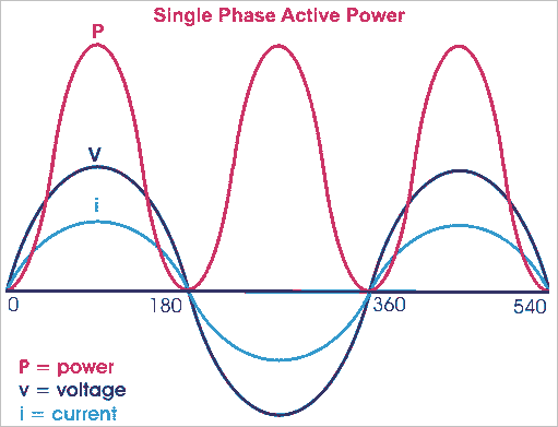

I know that when you get a current from a voltage (like calculating current through resistor), the current and voltage equations have the same frequency. Does this still hold for power P = VI ?
So assume V in Euler form, V(t) = Vcos(wt+theta) + jVsin(wt+theta) = V*ej(wt+theta) and in Phasor, V<theta = Vcos(wt+theta)
And assume I in Euler form, I(t) = Icos(wt+phi) + jIsin(wt+phi) = I*ej(wt+phi) and in Phasor, I<phi = Icos(wt+phi)
Then P = V(t)*I(t) = V*ej(wt+theta) * I*ej(wt+phi)
To get P = VI*ejwt+jwt+jphi+jtheta, call jphi + jtheta = jpsi
Then P = VI *e2jwt+jpsi
Then P = VI *ej(2wt+psi)
Then P = VIcos(2wt+psi)+jVIsin(wt+psi)
Real component is what we want, so P = VIcos(2wt+psi)
2wt (power frequency) isn't the same as wt (the frequency of current and voltage). Did I get the right result?

Think of the power as peaking on the positive voltage peak and the negative voltage peak, which is twice the frequency.
meBigGuy answered it
here's a picture to help
age=http%3A%2F%2Felectrical4u.com%2Felectrical%2Fwp-content%2Fuploads%2F2013%2F03%2Factive-power.png
any time volts and amps have same sign their product is positive
and that happens twice per line cycle
see - you learned that in first year algebra. Much of learning is really just discovering what we already know.
That's the picture I was looking for!
Not to hijack the thread but notice that there is now also a DC component. This is like AM modulation in that 2 signals are multiplied together to get sum and difference frequencies. In this case it so happens that the two input signals are the SAME frequencies.
The trig identity for squaring a sinewave (since power is E^2/R) shows the DC and the 2x frequency
