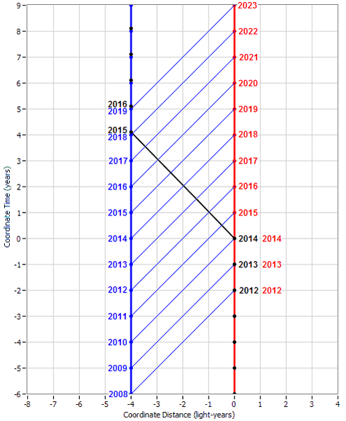

Take the advice you've been given so many times and draw a Minkowski diagram. There is no paradox.

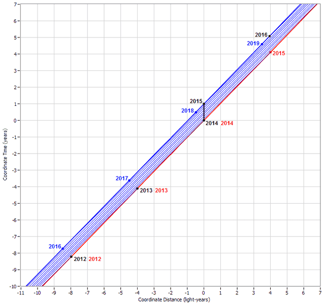

When the clock on Earth and on planet X reads 2014, our scientist Robert has three years to live, and will die when those clocks read 2017; the proton will reach Earth when those clocks read 2018.
Let's arrange things so that a clock carried by an observer who is at rest relative to the proton (after it's been accelerated) also reads 2014 at the moment that that observer passes planet X and the proton leaves planet X. According to that observer, what do the synchronized Earth and planet X clocks read? What will they read and what will the moving observer's clock read when Robert dies? When the proton reaches Earth?

Good "paradox". Congratulations :smile: (The quote marks are there for not to make people angry. )
Let's correct a small error: At velocity 0.9999 c the factor of change is 70.7. (I use the smaller one of the two velocities given.)
Travel time according to Earth clock: 1.001 times four years=4.004 years (1.001 times the travel time of light)
4.004 years divided by 70.1 = 20.8 days
About 21 days is the time measured by the proton's clock.
So you might say something like: For 21 days time the proton sees a time dilated Earth that is aging at rate 1/70.1 of the protons aging rate.
Trojan666ru said:
Suppose there has been an agreement for conducting an experiment between these planets. Scientists on Planet X accelerate a proton in a 'particle accelerator experiment' until the proton reaches a velocity of 99.99999999% c.
You have assumed a time dilation factor F of about 4 to 1 when the actual time dilation factor is about 70,711 to 1. That is a huge difference. For the time dilation factor to be 4:1 the speed of the proton would have to be about 0.866c which is not so convenient if we want to assume v ≈ c. It is unfortunate that you did not check this, because it means we cannot directly use your original figures.
I will go with a gamma factor of 4 and a velocity of 0.866c.
Once the proton is moving towards Earth, the simultaneity will be different in its new rest frame and and it will calculate the date is 2014 on planet X and 2017 (+ some months) on Earth. This is calculated using the simultaneity equation, which is L*v/c^2 where L is the distance between planet X and Earth as measured in their mutual rest frame. This works out as 4*0.866 = 3.46 approximately which means the time on Earth is roughly 3.5 years ahead of the time planet x. Now it takes L/v*1/F = 4/0.866*1/4 = 1.15 years to travel to Earth as measured by the proton. At the start of its journey the time on Earth was 2017 + 0.46 years so proton arrives at Earth at 2018 + 0.6 years approximately.
According to observers on Earth, the proton left planet X at time 2014 and takes L/v = 4/0.866 = 4.6 years approximately to travel, so it arrives and time 2018 + 0.6 years approximately.
The proton observer and the Earth observers therefore agree on the arrival time of the proton at Earth and everyone agrees Robert was dead before the proton arrived. No paradox.
Now let's do it again, very roughly, using your original velocity very close to the the speed of light and an enormous time dilation factor. At the start of the proton's journey, the time on planet X is 2014 and the time on Earth is 2018 using the simultaneity equation L/v ≈ 4. Due to the extreme time dilation it takes very little time to travel to Earth as measured by the proton, so by its reckoning, it arrives at time 2018 (+ a little bit).
According to the Earth observers the proton leaves planet X at time 2014 and at close to the speed of light, it takes just over 4 years to travel so it arrives at Earth at time 2018 (+ a little bit).
No paradox.

Here is a spacetime diagram depicting the scenario in the earth/planet rest frame. The Earth is shown as the thick blue lines with dots marking its years, the planet is shown in red and the proton in black:
Spacetime diagram with coordinate time in years on the vertical axis and coordinate distance in light-years on the horizontal axis, showing two worldlines: a blue Earth line at -4 and a red proton line at 0, with blue and black labelled year ticks and diagonal light-ray lines.
The thin blue lines show the image of the Earth time as it propagates to the planet and the proton. At the beginning of the trip in 2014, the planet and the proton see the Earth as it was in 2010. During the trip, the proton sees the Earth advancing in time at a rate of 1 year for each 45 days of the proton's time. Fifty days before the trip is over, the proton sees the year 2017 on the earth.
Here is a closeup of the important events tranformed into the frame in which the proton is at rest during the trip:
Spacetime diagram with Coordinate Distance (light-years) on the horizontal axis and Coordinate Time (years) on the vertical axis, showing two blue parallel lines with a shaded band between them, a red line, and labelled event points for years 2012 to 2019 in black, blue and red.
As you can see, nothing changes for any observer, either for what they see or for anything that happens to them.
Does this make it all clear for you?
