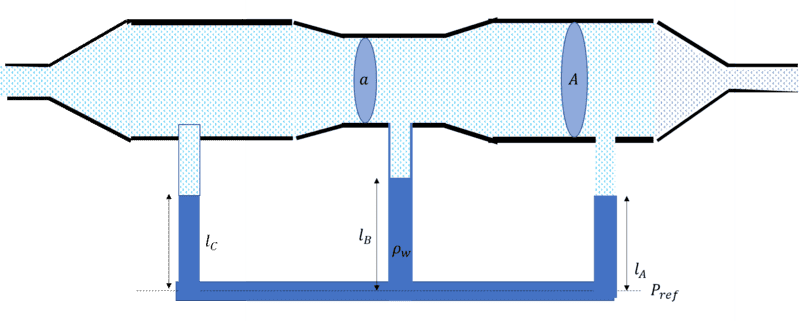

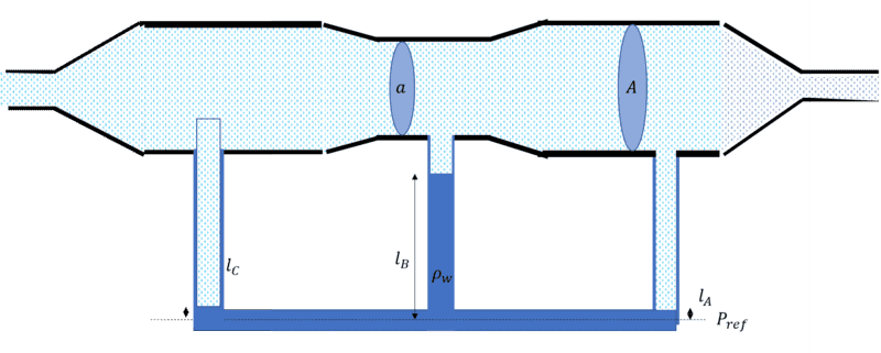

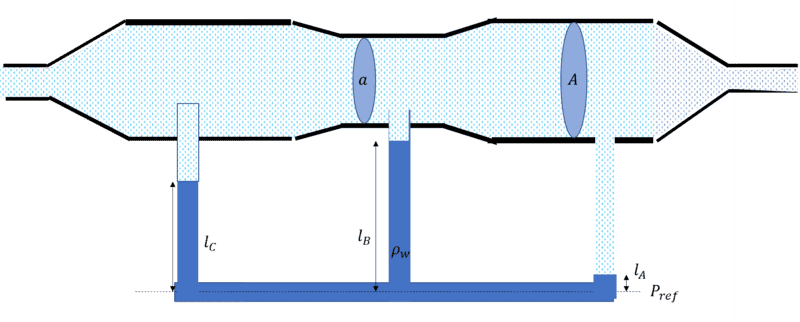

By deducing the scale of the image, I have done some rough estimates of the manometer pipe diameter and thus the heights of the water and wonder how we could calculate the flow rate in Kg/sec of the gas through the system?
Estimate of the diameter of the manometer tubes: 8 mm
Scale: say 1:1,
Measured heights above red line:
A = 0 mm
B = 97 mm - allowance for narrowing at the top, say 95 mm
C = 53mm
95 + 53 = 148 /3 = 47
1 Atm = 10332 mm = 101,325 Pa (x 9.8)
Each mm is 9.8 Pa
It seems obvious that the flow rate in each section has to be the same.
I think we'll need to take into account the temperature of the gas as it passes through the system, and make a guess at the ambient air conditions (20°C, 101.3kPa?) Also something about the diameters of the various chambers through which the gas flows.
My measurements of the water heights in A,B and C are:
S mm
A 0
B 95
C 53
I think the first step is to work out the pressure in A, B and C, but as they are mutually dependent, I'm not sure where to start. I think the heights would be different if the manometer tubes were independent of each other.

Does anyone know why the levels in A and C are not identical?
  • #67
Friction loss.

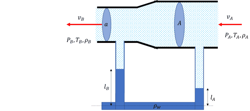

This is a little bit of a brain teaser/not enough information problem. At first glance, the lack of height change of C implies it is atmospheric pressure, but I think the reality is that the pressure is substantially higher than atmospheric. Based on the system shape the largest loss should be at the outlet and the loss through the rest shouldnt be much unless the velocity is high.
[Edit: beaten by @Baluncore ]
The air source is probably lab bench compressed air at 7 ATM or so (common value = 100 psi) throttled down with the valve. The flow is probably high subsonic/compressible and the air is cold. There might be a way to untangle this and figure out the velocities, but I don't see the value in it. It isn't worth the effort to me, especially given how the thread is going.
  • #72
Baluncore said:
True.
Since the manometers here only show differential pressure, we are missing the absolute pressure of the system, which makes pressure ratios difficult to assess.
Yeah, as @russ_watters mentions, we are going to need to pull a lot of figures out of thin air…quite literally for a computation.
In general if we assume adiabatic process between A and C then this is a constant enthalpy process:
$$ U_A + p_A v_A = U_C+ p_C v_C$$
I believe is the basic idea.

I think you should explore it by repeating the experiment with three manometers, open to the atmosphere. Then the ratios of the pressures can be known. At present, because the manometers are isolated from the atmosphere, only the differential pressures are known.
  • #81
Yes, indeed, that would be interesting. Unfortunately we have what we have.
It is the calculation of the differential pressures that pose a most interesting problem. Can hydrostatics resolve it?
Does the fact that the pressure at the base of each column must be equal provide a starting point?

But, lets ignore that and look at the equations you are willing to use:
The ideal gas law states ##P = \rho R_{specific} T## (we're going to do the ideal gas assumption here, I'm not willing to make it more complex than necessary). We don't have the pressure ##P## only relative differences, we don't have the density ##\rho## and we don't have the temperature ##T##. You need to assume at least two of the three variables.
A simple and to my best guess: valid assumption is that the temperature can be considered constant everywhere. Yes, kinetic energy is transferred to heat energy through friction, but it will not have a significant effect on the pressure and temperature I think (that's my educated guess based on my experience as fluid dynamics engineer, that's how I make my living...).
The density is another thing I think will hardly change in this experiment. The rule of thumb here is that for velocities lower than Mach 0.3 density can be considered constant. Mach is the speed of sound, Mach 0.3 in air at sea-level conditions is roughly 100m/s or 360 km/h. I think we are well below that... This is actually for external flow, but since the exit of this device is connected to the atmosphere, I would say this is valid, valid enough for our purposes anyway.
So, ##\rho## nor ##T## will change, does that mean the pressure is everywhere equal, since that would then be what the gas equation tells you right? Well no! What I'm saying is that the changes in temperature and density are small enough that it doesn't have a significant influence on the pressure, you will not learn anything new about the experiment by taking those into account.
If you would now insist to be 'more accurate' and take the changes of temperature and density into account anyway, you're not one single step closer to the solution. This is because the pressure differences and velocities are dominated, swamped really, by other effects than temperature and density differences.
This means the gas-equation will not help us. Since calorimetry is just heat transfer, and I've just told you that this is not important, we can ignore that as well.
Lastly hydrostatics. Hydrostatics tells you the pressure in a fluid that is not moving at all. The only way this becomes interesting is if gravity plays a role. In this case gravity does not play a role. Gravity is a potential force, long story short: you can take the Navier-Stokes equation for a single incompressible fluid and take out any potential force and you are still left with the same equation to solve, only the pressure is not an absolute pressure but relative to the pressure at some point. This means gravity has no influence over the dynamical behavior of the flow for this experiment.
So... what would solve this problem? The Bernoulli equation is a good start. But applying that would tell you that the pressure at A and C should be equal (Bernoulli is an energy conservation statement, it assumes no energy is lost), as pointed out by others earlier. Since this is clearly not the case energy is indeed lost. This is due to friction and turbulence. To compute how much friction there is and how much turbulence is generated you need to solve Navier-Stokes somehow. You can do assumptions here as well (you need a 'turbulence model') and maybe even derive some analytic relation, but that's way to complex and mathematically heavy to do on a PF thread (for me anyway).

I solved for the mass flow rate as a function of Chamber A pressure and Temperature ##\dot m( P_A,T_A)##, these are the independent variables. The specific enthalpies of the flow in chamber A and B for an ideal gas are fully specified by the temperature in a particular chamber. Which is specified downstream by the adiabatic assumption.
$$\dot m = \frac{P_A}{R T_A} A \sqrt{ \frac{ 2 \left( h_B(T_B) - h_A(T_A) \right) }{1- \left( \frac{P_A}{P_A+ \rho_w g ( l_A -l_b)} \right)^{ \frac{2}{ \gamma} } \left( \frac{A}{a} \right)^2}} $$
Where
##T_B= T_A \left( \frac{P_A+ \rho_w g ( l_A -l_b)}{P_A} \right)^{\frac{ \gamma - 1}{ \gamma}}##
