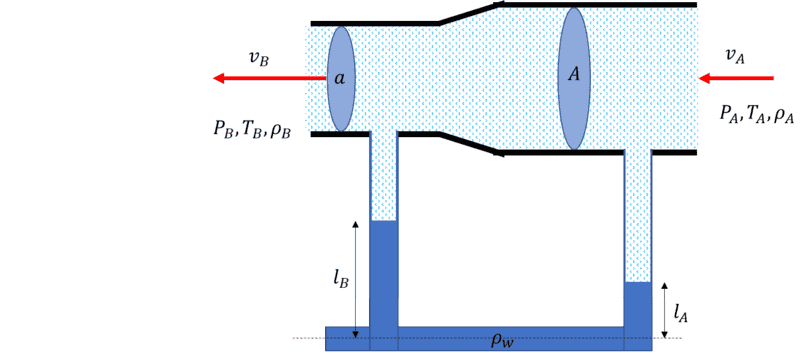

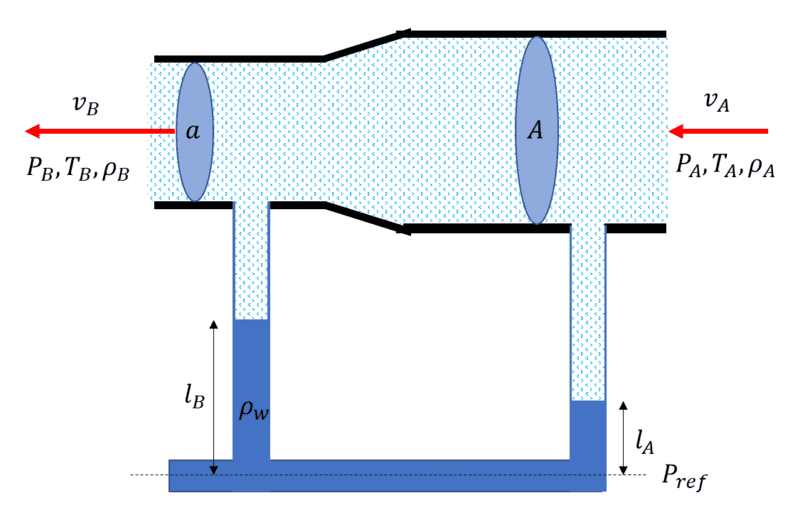

Does gas flow from low to high pressure?
The discussion revolves around the flow of gas in relation to pressure differences, specifically questioning whether gas can flow from low pressure to high pressure. Participants reference Bernoulli's principle and the Venturi effect, exploring the implications of pressure measurements in manometers connected to a Venturi tube setup.
  • Some participants interpret a demonstration showing air flowing from a region of higher pressure to one of lower pressure, questioning how this aligns with the principle that gas flows from high to low pressure.
  • Others argue that the observed pressure differences in the manometers are due to the velocity of the gas, suggesting that lower pressure in the constricted section corresponds to higher velocity, which is consistent with Bernoulli's principle.
  • A participant points out that the pressure in the third manometer appears higher than in the second, raising confusion about gas flowing from lower to higher pressure.
  • Some participants clarify that the flow direction and pressure readings depend on how the chambers are numbered and the interpretation of static versus dynamic pressure.
  • One participant emphasizes that gas can flow from low to high pressure if it has sufficient inertia, referencing the behavior of gases in axial compressors.
  • There is a suggestion that the understanding of Bernoulli's principle is crucial to resolving the confusion regarding gas flow and pressure differences.
Participants express disagreement regarding the interpretation of gas flow in relation to pressure differences. While some assert that gas cannot flow from low to high pressure, others provide counterexamples and explanations that suggest it can under certain conditions. The discussion remains unresolved with multiple competing views.
Participants highlight the complexity of pressure measurements in interconnected manometers and the distinction between static and dynamic pressure, which may influence their interpretations. There is also mention of the need for clarity in the numbering of chambers to avoid confusion.

  • #36
Sailor Al said:
And in the video, the air does flow from the low pressure of chamber B to the high pressure of chamber C.
I guess the problem lies in the word "flow".
Please explain? Flow is a very well defined term.

  • #38
Sailor Al said:
Again, no argument, this uphill flowing can be explained in simple physics terms of trading body's KE for PE.
[...] I'm still looking for a similarly simple physics explanation of how a gas flows from low to high pressure. I know it does, I just can't quite work out how.
So the water particle flows at the bottom of the hill at velocity ##v_1## and thus has ##KE_1 = \frac{1}{2}mv_1^2##. It also has some potential energy, ##PE_1 = mgh_1##. The total energy is ##KE_1 + PE_1##. And you understand that it will go uphill while decelerating, i.e. ##KE_1 + PE_1 = KE_2 + PE_2##, or:
$$\frac{1}{2}(v_1^2 - v_2^2) = g(h_2-h_1)$$
But a particle also has internal energy ##U = PV##, where ##P## is the pressure and ##V## is the volume occupied by the particle.
Ignoring ##PE## change for the moment, we get ##KE_1 + U_1 = KE_2 + U_2##, thus (assuming an incompressible fluid or ##V_1 = V_2 = V##):
$$\frac{1}{2}\frac{m}{V}(v_1^2 - v_2^2) = (P_2-P_1)$$
Where ##\frac{m}{V}## is the density ##\rho## of the fluid. That is the Bernoulli equation. If we assume that ##v_1 > v_2##, we can see that ##P_2 > P_1## or the pressure increases as the velocity decreases; Just like the height of a particle must increase as the velocity decrease when it goes uphill. The energy must be conserved.
The only difference with a compressible fluid is that ##V_1 \ne V_2## and thus the change in pressure is not that simple. A relation must be determined between pressure and volume. (And that relation is usually the ideal gas equation.)
