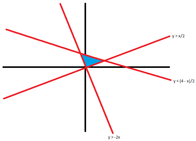

Make a good sketch of the plane region D defined by the following simultaneous inequalities:
D: y >/= -2x, 2y >/= x, 2y </= 4-x.
Use deep conceptual understanding the insight (and no antiderviative calculations!) to reduce the iterated integral below to a simple algebraic expression depending on the parameters a, b, and c:
I = ∫∫(a+bx+cy)dA.
Enter the value of I corresponding to a = -0.8, b = 0.7, and c = -1.2.
a) -7.04
b) -6.00
c) -4.67
d) 8.07
e) 2.74
None, other than the integral equation provided in the question.
As asked in the question, I made a quick sketch, shown below:
Then I used the dot product to figure out that the region in consideration is a right triangle. Hence, it was easy to calculate the area of this region in the 2D plane. I calculated it to be:
A = 3.097097656
Now, I don't know how to extend this idea to calculate the volume since f(x,y) is not constant.
Any help would be greatly appreciated. Thanks!

What does the equation, z = a+bx+cy represent ?
Hm... it represents a plane. Are you suggesting that I find the volume of the two pieces (triangular base + another triangular piece on top with the slanted plane)?
No, SammyS and I are both suggesting you think of it as a volume integral.
I don't think your area A is correct. I suggest re-calculating it with exact values instead of decimals. Also, it isn't difficult to find the centroid of a right triangle. Your problem can be thought of as the volume of a triangular prism with slanted top.
Are you sure the values for a,b,c and the answer choices are all typed correctly?
[Edit] Never mind about the typing, all is correct except your area is only sort of close.

For each ##(x,y) \in D##, the integrand ##f = a + bx + cy## is ## f = a + \vec{u} \cdot \vec{r}##, where ##\vec{u} = (c,d)##, ##\vec{r} = (x,y)## and ##\cdot## is the inner product. Since integration is a 'linear' operation, we can pull the ##\vec{u} \cdot (\cdots)## outside the integral, to get
[tex]\text{integral } = a \int_D\, dA + \vec{u} \cdot \int_D \vec{r} \, dA.[/tex]
Do you recognize both of these integrals, perhaps from a physics course or somewhere similar?

How do you calculate the location of the centroid of a lamina?

Well, for a right triangle, it's simple as the formulas are already dervided online. Or, we could simply integrate using (assuming density is constant):
x_centroid = 1/A * ∫∫x*dA
y_centroid = 1/A * ∫∫y*dA
Suppose I do find the centroid co-ordinates, how does that result into determining a volume? I feel like I am missing something big here but I just can't see it.
CallMeShady said:
Well, for a right triangle, it's simple as the formulas are already dervided online. Or, we could simple integrate using (assuming density is constant):
So you could rewrite those as$$
\bar x A =\iint x~dA,~~\bar y A = \iint y~dA$$Can you use that to rewrite your problem$$
I = \iint a + bx + cy~dA~\text{?}$$

No, I meant that there are two physical interpretations available for your integral: as the volume of a prism (or tetrahedron if you do the co-ordinate rotation); or as the centroid of a lamina. The second is definitely easier.
Interesting stuff.
So I broke up the integral and recognized this:
I = a∫∫dA + b∫∫xdA + c∫∫ydA.
The first terms is simple "a" times the area, the second term is the centroid of x times the area times b, and the last terms is the centroid of y times the area times c. My centroid points appear to be correct (intuitively from the graph), but my final answer was -1.967611565. None of the options have this answer included. So, I am going to do what LCKurtz said about re-calculating the area and I'll update.

That's the idea. You should give exact values for the area and the x and y centroid values, so your formula for I is exact.

Do you have the coordinates for the centroid of the base?
The equations x' = x cos(θ) + y sin(θ), y' = -x sin(θ) + y cos(θ), are to rotate a point about the origin, right? I would have guessed you'd be (notionally) rotating the triangle clockwise to align with the axes, finding the centroid of that, then rotating back anticlockwise. But (x, y) is not that centroid (a factor 3 too much, so actually the far corner of the rectangle of which the aligned triangle is one half?), and the rotation you've used is clockwise, not anticlockwise.
The centroid co-ordinates are (1.110899311, 0.555130063). The first co-ordinate is for the base. Basically what I did was position the right triangle's base on the x-axis, and then find the centroid co-ordinates of it. Then I rotated the triangle by 26.5 degrees counter clockwise in order to obtain the actual centroid co-ordinates to match the question.
(1.110899311, 0.555130063) are not the centroid coordinates for the figure in your original post .
And as haruspex mentioned, the formula I was using did not rotate the co-ordinate counterclockwise. A quick Google search led me to the correct formula, and now I can satisfyingly say that I found the correct answer:
I = -7.027811891
It's off by 0.01 from one of the answers, but that should be close enough. Assuming that this is, indeed, the correct answer, I thank you all for your help. You guys are awesomely patient and helpful. :D
