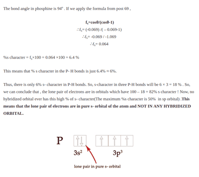

Drago's rule was introduced to explain why the bond angles of molecules such as ##PH_3##, ##AsH_3##, ##SbH_3## differ so much from ##109^o28'## which is supposed to be the ideal bond angle of molecules with ##sp^3## hybridization(as the steric number ##Z = 4##). Is the fact that Dragos rule exists prove somewhat the failure of hybridization theory as the theory itself predicts the bond angles to be ##109^o28'## but in actuality, the bond angles are closer to ##90^o## hence implying hybridization does not take place?
The theory of hybridization does not account for the bond angles of these elements to be (##\approx 90^o##) and Dragos rule was born out of only experimental data.
The only theoretical proof that I have found that predicts Dragos rule is
(https://madoverchemistry.com/2018/1...l-bonding-24-covalent-bonding23-drago-rule-2/)
I am unclear as to how they get those equations(I can't find post 69 but I suspect its an equation from orbital analysis but I am not too sure) here it is proving by contradiction that no hybridization is going to take place in phosphine(##PH_3##) instead of solely relying on experimental data.
so in short I don't understand:
1. the theoretical prediction of Dragos rule(which is given in the link above) using orbital analysis.
2. If the fact that Dragos rule exists proves the failure of hybridization theory.

If I understand correctly what is happening here is this:
1. There exists a general theory (call it Q) allowing us to describe electrons in any molecule.
2. This theory is way too inconvenient for everyday use, so we devised a simplified theory O, based on Q.
3. O is simplified, so it doesn't account for some phenomena we observe in reality, thus we add another theory, H, that helps us describe them.
4. Because of these simplifications O with H still fail, so we add an experimental rule D, to predict when H stops working.
Now you are trying to find a rationale behind O, H and D, that will allow you to treat them the same way we treat Q. Well - it won't work, because O and H are just simplified attempts at explaining the more complicated reality. In a way there is no need to prove they are wrong, as they are wrong by design. They do share many characteristics of the full theory Q, but they also ignore some details, so by definition now and then they have to fail.

also, I still don't understand the equations in the post above that predict the %s character.
Broadly speaking Q is the quantum theory based on the Schrödinger equation [itex]H\Psi=E\Psi[/itex].
Note that the notion of orbitals (O) is a simplification. Schrödinger equation describes the system (atom, molecules) as a whole, and its solution doesn't treat every electron individually. Assigning electrons to orbitals and finding solutions in terms of these orbitals makes math easier and results much more palatable, but in general it is only an approximation. In many cases a very good one, but not always - that's why we need tricks like hybridization. MO is another variant of a simplified theory - similar to O, just applied to larger systems.

Strangely enough, for at least 50 years now, no theoretical chemist believes any more in the geometry being dictated by hybridization. Yet teachers don't stop parroting this old lore.
