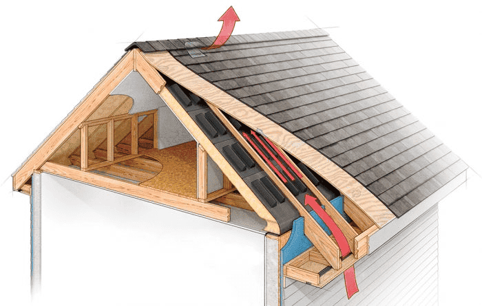

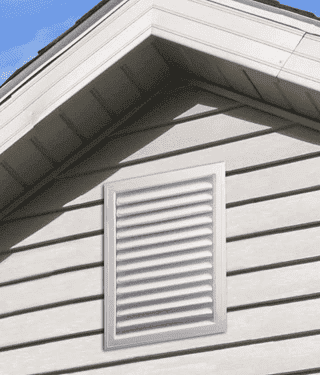

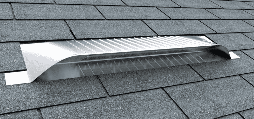

I'm wondering if attics supposedly have air vents to let air flow in and out, how is it that these "holes" in the attic also don't let water come through during rain?
Like these type of attic vents? Looks pretty rainproof to me...
https://www.gaf.com/-/media/hero/pr...hash=3AB0548E9D44315297DE8CDB6AC201C32CCBF9B5
Vents in attic walls are protected by louvers; horizontal slats set at an angle to inhibit rain but allow air. Louvers also keep out larger pests such as rodents and birds.
Vertical vents commonly use pipes through the roof. The top of the pipe is protected by a raised cone or cap larger in diameter than the pipe. Rain splatters off the cone but air comes through the gap.
Any of these openings can be protected by a metal mesh, a screen that allows air flow but inhibits insects. Some attics have small screened windows perhaps with an overhang.

Most building codes require an insect screen behind the louvers and any other path into the attic.
With enough wind speed, rain-driven rain will penetrate the attic space.
Some industrial and properly designed louvers reduce that type of penetration very well.
Depending on type of house your talking about (gable/hip) there are 2 basic types of intake flow vents (gable vent / Soffit vent) respectively. House that have gables usual don’t have as many exhaust flow vents due to flow ability and how wind can drive thru attic. There is a specific formula based upon surface area of roof : area of house footprint that calculates needed intake surface area and proper exhaust flow depending on vent type. But as long as your shingles (laminated) don’t look like burnt toast intake/ exhaust ratio isn’t damaging shingles

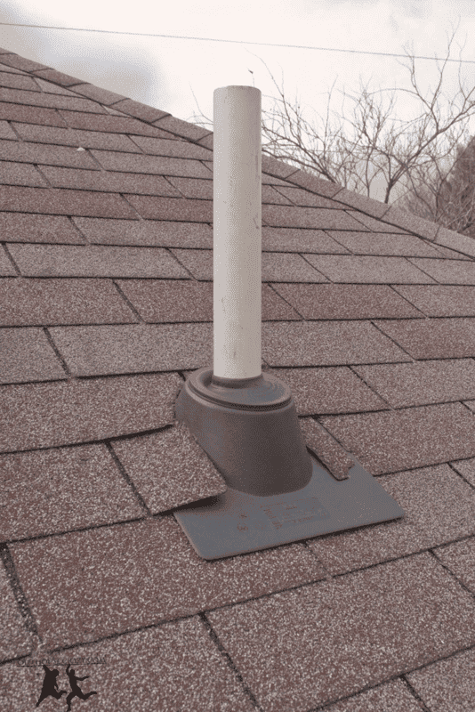

The vertical pipes sticking out the roof have nothing to do with ventilating the attic. They are sewer vents.
If anything drains into the sewer vent is considered part of the drain waisted vent system and will be protected with a trap to prevent sewer gas from escaping. Whatever device that drains into the sewer vent happens to reside in an attic well then that is coincidence. The sewer vent is meant to vent the sewer system, not the fixture or appliance that happens to be hooked to it or space the said appliance resides in.
Edit: I should be a little more careful with my wording. A vent pipe that is part of the main DWV system that runs from an individual sink for instance is said to vent the sink. But what it actually does is allow air to follow the drain water away from the sink. If this is not provided there is danger of the trap under the sink being drawn empty or close to empty which will low sewer gas into the room.
So again, the vertical pipe pictured in post #6 is just a sewer vent and nothing else.

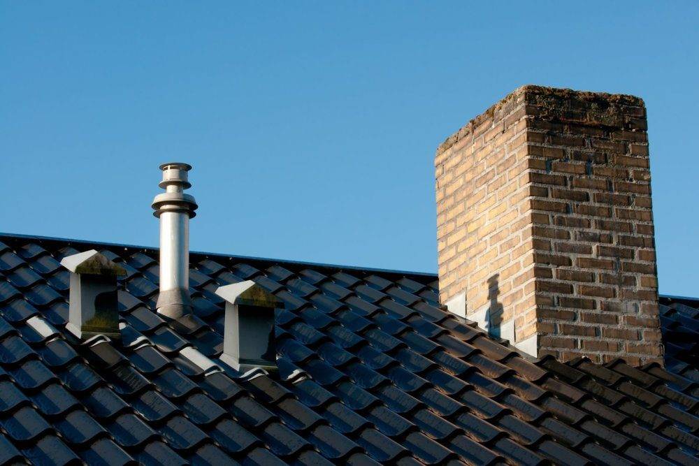

or vent for a gas appliance,
vent-a-hood for stove top
Few others that off the top of my head escape me

I referred to the pic in post #6. 'Nuf said I think.

Someone has deleted their post. I thought they were referring to the pipe in post #6. So, this is what my replies were aimed at. I have to assume who delete and dash poster was figured out they were wrong. Chicken way out if I've ever seen it.
Ahhh👍🏻 well those are definitely pvc (1-1/2” ; 2” ; 3” ;4” etc.. ) vents that supply sewer drain air relief for anything that drains to city connected water supply in #6 comment 💯 right
