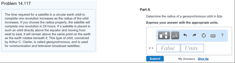

Screenshot of an online homework problem 14.117 with a text paragraph on geosynchronous orbits, and Part A asking for the radius of a geosynchronous orbit in km, with an answer box labeled r = Value Units and a Submit button.
ε= r_max - r_min / r_max + r_min
= r*v2 / gRE
I first find that 1 revolution is 2π rad , the angular velocity ω = 2π rad / 24h = π/43200 rad /s
so v = rω where r is the unknown
ε = 0 (circular orbit)
r*(rω)2 / g RE = 0Correct route?
Your approach is incorrect. You need to use Newton's 2nd law to find a relation between speed and radius in a circular orbit.
st
start with F= ma, then integrate?
No need for integration. Remember that the acceleration here is centripetal. What is an expression for F?
No, a is the centripetal acceleration. What is an expression for it? F is the force of gravitational attraction between two masses according to Newton's law of gravitational attraction.
Centripetal acceleration is ω2r, not ωr. Also, what is r'' for a satellite in a circular orbit?
