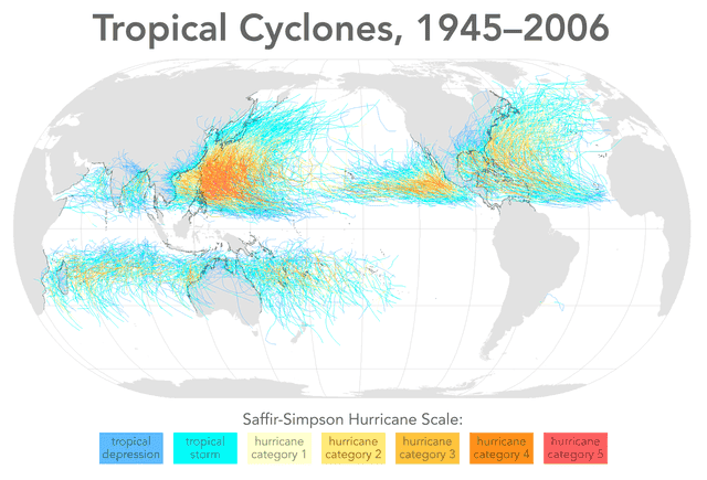

The coriolis effect is rather weak, and it is essentially non-existent at or near the equator.
Here's a map of tropical cyclones from 1945 to 2006. Note that there are no tropical cyclones right at the equator. That's because the coriolis effect is very weak near the equator.
