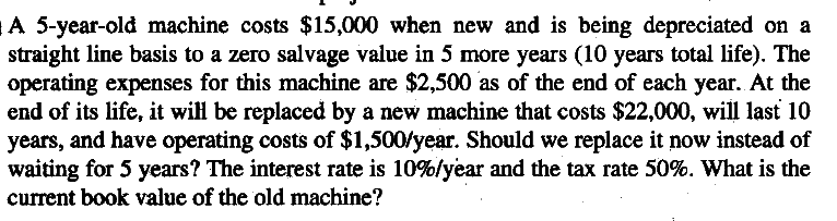

I know it's not directly related to engineering, but its from an engineering economics course!
Hello, I'm trying to solve this problem, and my first thought it to find the present value of each machine
$$ PV = C_{D}t[1-(1+i)^{-n_{t}}]/(in_{t}) $$
Where ##C_{D}## is the depreciated value, ##i## is the interest rate, ##n_{t}## is the depreciation life (tax purposes), and ##t## is the tax rate.
When comparing the old machine and the new machine, I found ##PV_{old} = $516.9##, and ##PV_{new} = $614.4##, so it would mean the new one is presently worth more. I used ##n_{t,old} = 5## and ##n_{t,new}=10##. ##C_{D} = C_{I}-C_{S}## where ##C_{I}## is the initial cost, and ##C_{S}## is the salvage value. However, I am not sure how I should incorporate operating expenses in my calculation, which leads me to believe what I am doing is incorrect.

I wouldn't use an equation to work this out. I would start by determining the cash flows for the two scenarios and then determine the net present value of each scenario.

I really don't like what you did here, and I don't think that your results are correct. Here is an assessment of the cash flows for the scenario of waiting the 5 years before purchasing:
End of Year 1:
Operating cost= -2500
Tax refund on operating cost = +1250
Tax refund on depreciation = +750
Net cash flow at end of year 1 = -500
Same for years 2-4.
End of Year 5
Same as years 1-4, except purchase cost of 22000.
Net cash flow at end of year 5 = -22500
End of years 6-15:
Operating cost = -1500
Tax refund on operating cost = +750
Tax Refund on depreciation = +1100
Net cash flow at end of years 6-16 = +350
These case flows can be used to calculate the NPV of scenario 1.
In my judgement, scenario 2 (immediate purchase) is somewhat ambiguous, for the following reasons:
1. Scenario 1 involves having a machine to use for 15 years. In scenario 2, what do you do after 10 years (when the useful life of the new machine has expired)?
2. Can you sell the original machine at time zero to recover its salvage value?

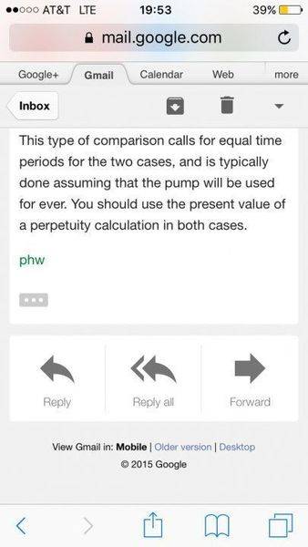

Turns out all this work may have been moot, here is what the professor said when I asked about the two possibilities
Ah. That makes things a lot easier. All you need to do then is sum some infinite geometric progressions.

Definitely not. For scenario 1, you have:
$$NPV=∑_{n=1}^5{\frac{-500}{1.1^n}}+∑_{n=6}^∞{\frac{350}{1.1^n}}+∑_{n=1}^∞{\frac{-2200}{1.1^{10n-5}}}$$
