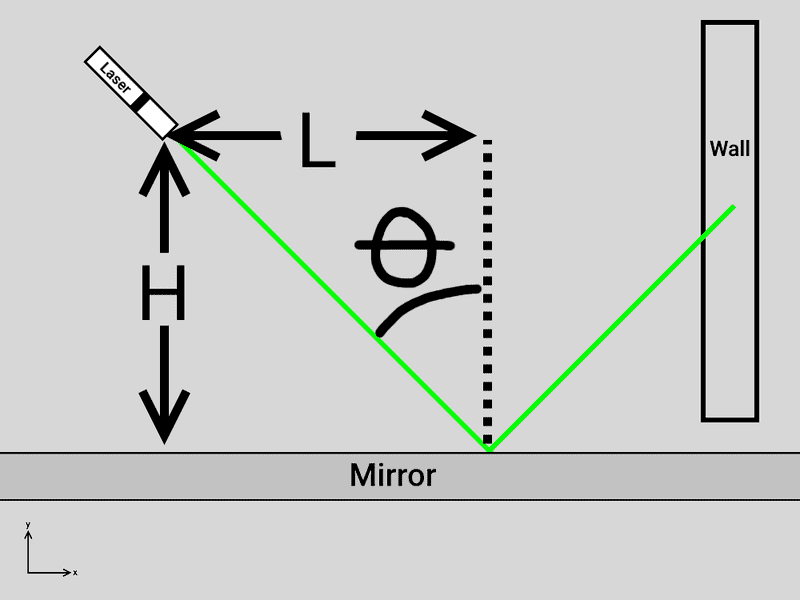

Let's say I have an apparatus that's set up like this
Let's also say that the mirror is infinitely long.
If the mirror starts moving at subluminal speeds in the x axis, what would happen to the path of the ray of light? Would the dot made by the ray of light on the wall go up?
The reflected dot will go up over time, yes.
I believe you will also find that the angle of incidence and the angle of reflection will not match. If you bounce the light from a stationary mirror and from a moving mirror that is [momentarily] at the same position, the reflected light from the moving mirror will strike the screen farther up. But I do not have any calculations to back that up with.
Oh... on the _x_ axis. Never mind. No effect.
We have two frames: one in which the mirror is moving while the wall and light source are at rest; and one in which the mirror is at rest while the wall and light source are moving. The angle that the light makes at the mirror is different in the two frames, but the point where the light beam hits the wall is the same.
If it's an ideal mirror, which exchanges momentum along the y-axis only, then there will be no effect from it's movement along x. It's analogus to collision with an ideal friction-less surface.
