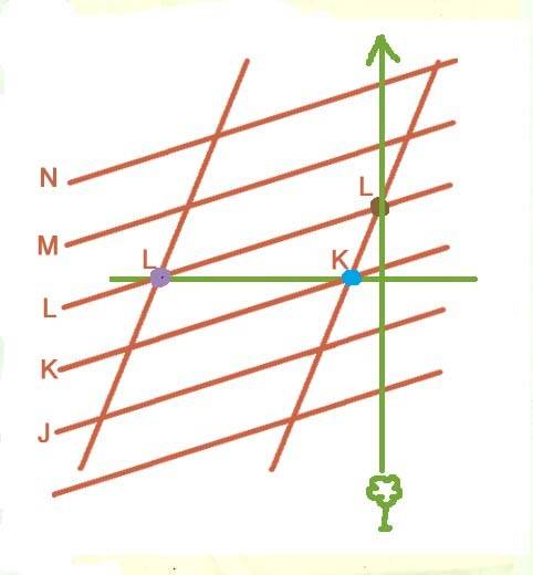

In Dave's train (orange) somebody at the back of the train and somebody at the front of the train both recite the alphabet simultaneously.
Dave measures his train between the brown and purple event; when for him person at the back and the person at the front of the train say 'L'. Notice I have added a tree.
From the trainstation Mary measures the moving train between between the purple and blue event; between person at the back saying 'L' and the person at the front of the train saying 'K'.
I do not see any projection taking place. There are no events projected from the orange line onto the green horizontal line. F.ex. the brown event 'front of train at tree' is not dropped on the green line and replacing the blue event.
Orange and green are rather different 'cuts' through the timelines. 3D cuts though 4D spacetime.
I find 'projection' rather confusing terminology. Even wrong. Why?
If I project a photo of a train (with the front of a train hitting a tree) to the wall under an oblique angle, the train will be projected shorter, but still hitting the tree. (Similar line of thought can be said about some perspective drawing). So writing for the the layman that lengthcontraction is a 'projection' will never make him understand what relativity of simultaneity is, the crux of special relativity.

"Projection" may not be the best word to describe it, but it's a word that's often used. You are correct that what is projected is not events. See further comments below.
Yes, and one way of viewing what the "cuts" do is that they "project" the object into different simultaneous spaces. But the terminology isn't important; what's important is the physics. Your diagram correctly represents the physics.

The object 'train' in one space of sim events is a cut through the 4D train object in 4D spacetime, and the object 'train' in another space of sim events is a different cut through the 4D train object.
I think that's the best description of the situation, and your previous space-time diagram shows exactly what you have said here.

I already said that "project" may not be the best word to describe it. And I already said that your diagram correctly captures the physics. At this point you're just arguing that you don't like me calling it "projection". That's an argument about terminology, not about physics.
