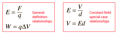

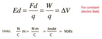

http://hyperphysics.phy-astr.gsu.edu/hbase/electric/elewor.html#c1
Work and Voltage: Constant Electric Field
The case of a constant electric field, as between charged parallel plate conductors, is a good example of the relationship between work and voltage.
Diagram of a parallel-plate capacitor with a row of plus signs on the top plate and minus signs on the bottom plate, arrows showing a uniform electric field between them, labelled V, d and E = V/d.
The electric field is by definition the force per unit charge, so that multiplying the field times the plate separation gives the work per unit charge, which is by definition the change in voltage.
Equation Ed = Fd/q = W/q = ΔV, labeled for constant electric field, followed by units line: N/C m = N m/C = Joule/C = Volts.
Two red-bordered boxes of equations. Left: E = F/q and W = qΔV, labelled General definition relationships. Right: E = V/d and V = Ed, labelled Constant field special case relationships.
Might that be a contributor to your perceived paradox?
