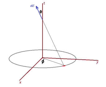

This I understand. But how can we obtain that by calculation? In this case, the total field (counting only the vertical components) is ##\vec{E} = \int_{S}^{}\frac{\lambda* cos\theta\hat{z}}{R^2+z^2}ds## (S being the ring), where we can simply multiply the integrated function by ##2\pi R##. Why does not a similar calculation with ##sin\theta\hat{x}## instead of ##cos\theta\hat{z}## yield 0?
The x-component of ##dE## for an arbitrary segment is not given by using a factor of just ##\sin \theta##
Show that the x-component of ##dE## shown above is ##-dE\sin\theta \cos \phi##. The net x-component is obtained by integrating with respect to ##\phi##.

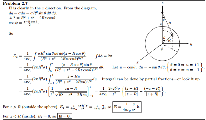

I have one more (related) question. In the attached exercise, to obtain ##E_{z}##, ##E## is multiplied by ##cos\psi##. Why is it so?
Note that for the element of charge shown, the angle between ##d\vec E## and the z-axis is ##\psi##. So, you get the z-component of ##d \vec E## by multiplying ##dE## by ##\cos \psi##.
