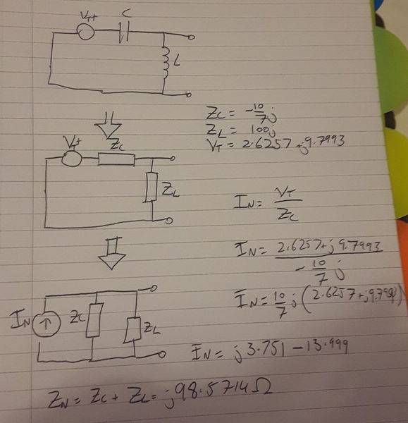

I've re-done my working out for Vo considering that 1/j=-j, am I correct?
Check the value you've used for the capacitor reactance. It should be 10/7, not 7/10. The capacitor impedance is ##-j\frac{10}{7}##.
Ah I understand now! Using -10/7 as the capacitor's impedance I got Vo= 2.6257 + j9.7993
Yup. Much better. Be sure to use this corrected capacitor impedance in your Thevenin Impedance calculation, too.

Alright thanks,
And for nortons, is it right to assume that all the current in the circuit runs into the load:
since you have to short circuit the load to find the current for all the circuit's impedance
and then divide the voltage provided by this impedance to find the circuits current,
and since there's no element leading into the load, there's no current divider to solve, thus all the current runs into the load?

Regarding the Norton equivalent, you can start from scratch to determine it, applying the usual procedure of determining the short circuit current and so on. Or, which is more expedient, directly convert the Thevenin model you already have to a Norton model. Their relationship is very simple.
You are correct that shorting the output effectively removes the inductor from consideration. You still have to deal with the capacitor and the phase inherent to the voltage supply.
So can it simply be a source transformation from your thevenins? with the new value for I being I=V/Z with Z being from the previous answer? and V being from the voltage source

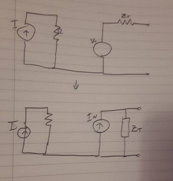

@gneill also do we now take into account the current source and resistor on the left? since there is no longer a short circuit, as there will now be a current source there
No. The short still divides the two circuits.
Here's the situation with the Thevenin model in place:
Replace the Thevenin model with a Norton model. What do you get?

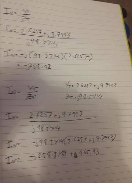

Sorry about the delay, only just had a chance to give part C a go!
I'm feeling a bit more sure about this part, but I've attached my work anyway just to be sure
Ah. You've mixed the Thevenin model with the original circuit there. You can't just drop the Thevenin voltage into the original circuit as it already expresses the effects of the other components.
You can, on the other hand, start with the entire Thevenin equivalent circuit and proceed from there. A Thevenin equivalent entirely replaces the original circuit and exhibits the same behavior. So you can convert the Thevenin model directly to a Norton equivalent.
Yes. It's common practice to rename ##Z_{th}## to ##Z_N## for the Norton model, even though they have the same value.
So as for the calculations, where I've previously used Zc, should I just use Zth to work out In?
Yes. Once you've got the Thevenin equivalent you can throw out the original circuit and never look at it again :smile:
I've re-done my calculations using Zth instead of Zc, does this look better?
