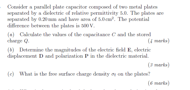

Printed exam question on a parallel plate capacitor with two metal plates separated by a dielectric of relative permittivity 5.0, 0.20 mm apart, area 5.0 cm², potential difference 500 V. Parts (a) to (c) listed with marks; part (c) asks for the free surface charge density on the plates.
trying to do question C

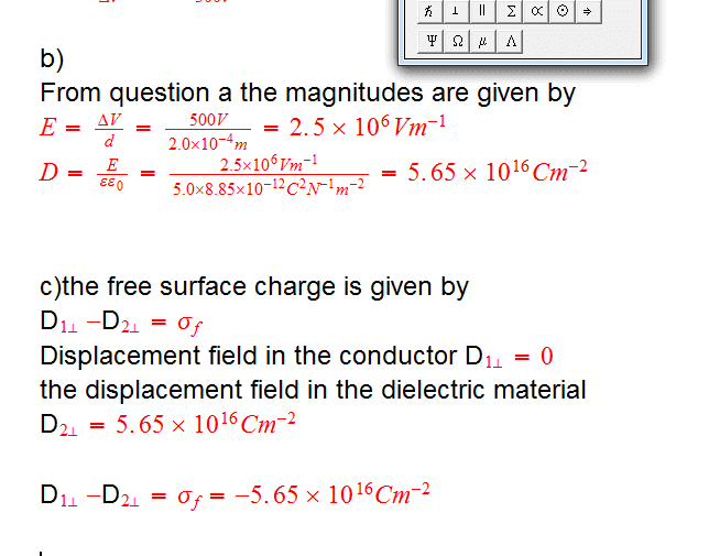

I know my answer to C cannot be right because it's worth six marks, any help or tips would be greatly appreciated. :)
Handwritten worked solution with red equations: E = ΔV/d = 500V / 2.0×10⁻⁴m = 2.5×10⁶ Vm⁻¹; D = εE = 2.5×10⁶ Vm⁻¹ / (5.0×8.85×10⁻¹²C²N⁻¹m⁻²) = 5.65×10¹⁶ Cm⁻²; then D1⊥ − D2⊥ = σf, with D1⊥ = 0 and D2⊥ = 5.65×10¹⁶ Cm⁻², giving σf = −5.65×10¹⁶ Cm⁻².
Check to see if you have the correct relation between D and E.
thanks TSny you're right I have got that the wrong way round, I am more perplexed by question c though, how to find the free surface density, if I had the correct value for the displacement field of the dielectric would my answer for c be right? I'm assuming it wouldn't as it's awarding 6 marks, so must be more complex.
I think your answer for (c) would be correct once you use the correct expression for D in terms of E. Maybe they feel that (c) requires more conceptual thought in using Gauss's law for D.
