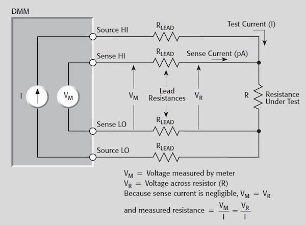

Perhaps this is a visualization problem; see the diagram for the four-contact sensing:
http://en.wikipedia.org/wiki/Four-terminal_sensing

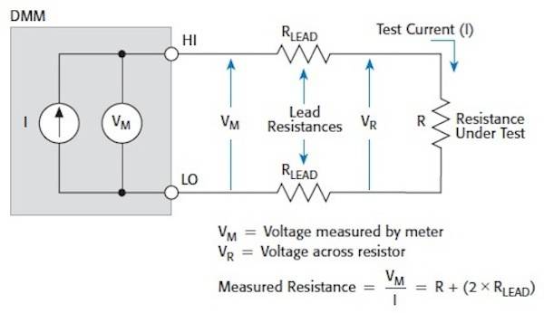

It's simply a method (Kelvin connection) to eliminate the effect of sensor wiring/contact resistance (causing a voltage drop from the voltage source to the material at the probing points) changing the probed materials voltage reading with very low resistance measurements that need significance current levels to generate a measurable and stable voltage potential.
I think you mean sheet resistance instead of 'Transresistance' as sheet resistance is what we normally use when measuring doping/implant levels in semiconductor wafers with very low resistance levels.
http://en.wikipedia.org/wiki/Sheet_resistance
