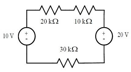

I'm trying to google for some but results often lead me to forum questions, theory articles, etc. Basically I'm looking for circuits questions with parallel voltage sources answers, where I am supposed to do the work to find out the solution for the current.
Hi Fp! :smile:
I'll give you a problem (found on PF).
[PLAIN]http://img297.imageshack.us/img297/7053/96217079.jpg
given this circuit find the current on R1,R2 and R3.
Can you solve it?

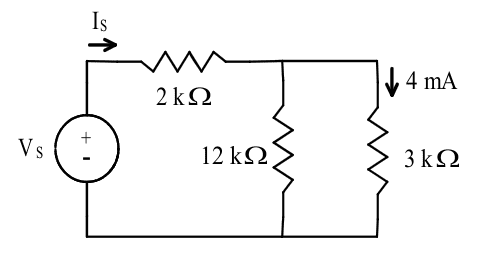

How about this one?
[PLAIN]http://img25.imageshack.us/img25/4407/circuitj.jpg
Eep.Yikes.
Looks intimidating.

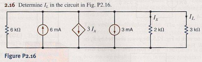

Once the item has inspired you enough to finish the problem, I have another one here.
I hope it's not too easy! :devil:
Uh, where are the voltage sources?
Who needs voltage sources, when you can get current sources?
Or are you certain you won't get those?
It seemed smart to me, to not only practice exactly the same problem over and over, but to vary it a bit and make sure you're not thrown off by some detail that should not matter.
The method is exactly the same...
Yes, but I don't know where are they located! Shouldn't you tell me at least where are they located if not their value?
There are no voltage sources.
Instead there are current sources that are similar.
An (ideal) voltage source provides a constant voltage.
An (ideal) current source provides a constant current (the voltage drop is zero).
Oh, well we haven't studied about that, I'm pretty sure it's not going to be on the test! Should I really be trying to solve that?
You can transform voltage and current sources interchangeably with resistors.

Well, what's the physical difference between a current source and a voltage source? Voltage source is plus and minus. A place with lower amount electrons connected to a place with greater amount of electrons...Is a current source the same?
Uh yes, in the sense that you mention it is the same.
The physical difference is that a voltage source has a fixed voltage difference and a variable current, depending on the circuit.
Whereas a current source generates a fixed current and a variable voltage difference, depending on the circuit.
(Btw, I have to retract my statement that the voltage drop across a current source is zero. It isn't.)
Hmm...then do I treat a voltage source like a current source when I build my equations? Or do I discount V and build the equations?
Can I get a good morning from you? :smile:
Start with building the equations that you think you can build.
You should be able to apply KCL.
Use KVL only on loops that do not contain a current source (since you won't get useful information from that).

I did say "heya" at the other thread! :approve:Can I minimize this last circuit to this?
http://img580.imageshack.us/img580/4282/minimize.jpg
Yep!
I was wondering if you got that physical concept and it appears that you do! :approve:

There are so many confusing things about this. Starting with this:
What do the circle and square signs mean? Are these current sources?
Yes, the circle and diamond signs are current sources. :)
Circle for constant current specified next to it.
Diamond for a dependent current source that provides the current specified next to it.
What's so confusing about it? :confused:
Or is it just that you didn't see it before?Edit: Oh, and here's a more detailed explanation from someone you already know:

But where it says "mA" -- how am I supposed to know where mA is Ix or IL?
mA means milliampere.
It's the unit of the corresponding current, which is neither Ix nor IL.
