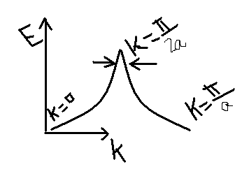

the point is that the
Energy = function(k) = function(k + pi/a)
which mean it should be a periodic function. when you draw energy from k=0 and k=pi/a they reach at k=pi/2a (BZ surface). in this intersection you should add the effect of both. dE/dk = momentum is one side positive and one side negative so the superposition of both are zero.
one can describe situation from wave point of view. when the k vector is on the surface of BZ, the energy of two waves are equal and their k-vector are opposite so you would have a standing wave (total momentum = 0 or dE/dk=0).
