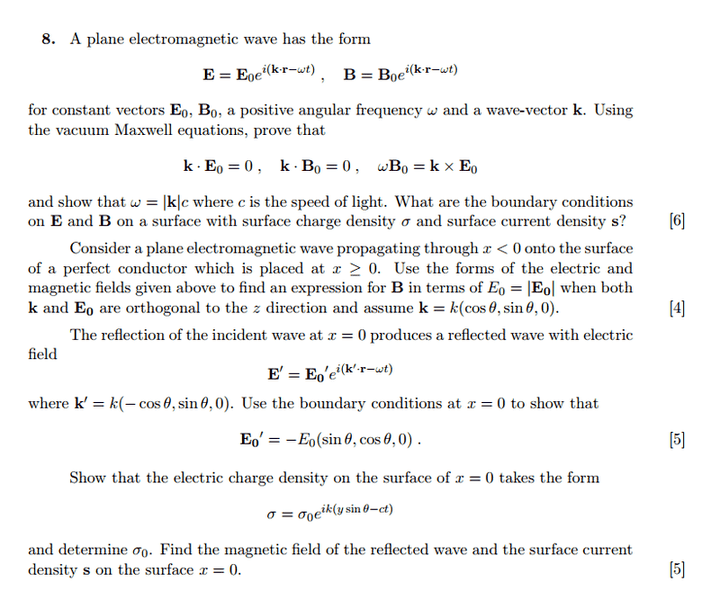

EM Waves propagating through vacuum towards the x-direction approaches a conducting surface at x = 0.
Part (a): Prove the following relations. Find the boundary conditions for [tex]E [/tex] and [tex]B[/tex] if charge density [tex]σ[/tex] and current density [tex]s[/tex] exists on the surface.
Part (b): Find [tex]B[/tex] in terms of [tex]E_0[/tex]
Part (c): Show the reflected wave has the following form:
Part (d) Find magnetic field of reflected wave and [tex]s[/tex]

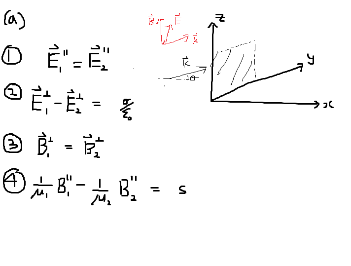

Part(a)

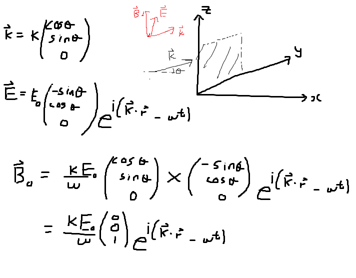

Part(b)

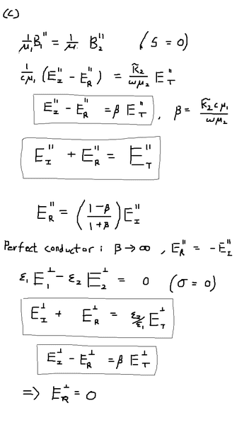

Part(c)
This is the part that disturbs me. I assumed the free current s = 0 and σ = 0. Usually [tex]k[/tex] would be perpendicular to the surface, making derivations easier.
I actually got perpendicular reflected E-field = 0, which is wrong..
But, I got parallel reflected E-field = - incoming parallel E-field, which is right
I'm confused - If it's a perfect conductor it should have no free charge or currents, but the question says it does. Then again, in order to derive the reflected e-field, we need to assume they are 0.
