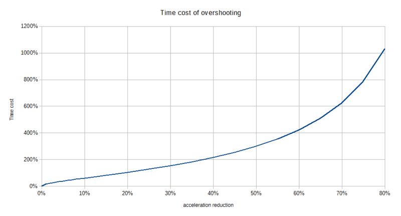

In my story, I need an "emergency brake" from 0.1 c to a full stop - even though this puts the entire ship's mission in jeopardy. The reason I cite is therefore a (an impending?) failure of the deflector systems: If the ship kept going at 0.1 c, they would eventually run into a dust particle that would blow up the entire craft.
Using the g-Acceleration Calculator from "rechneronline" (German website), braking from 0.1 c to 0 c at 4 g (anything beyond that would make humans black out, as far as I know) would take 213 hours, 42 minutes and 21.93 seconds. That's the way Data would put it - in simpler terms, this is almost 9 days.

If propulsion is an ordinary rocket then all the fuel would be used up doing this, so you are pretty much hosed anyway.
Strato Incendus said:
And if the ship could constantly accelerate at 1 G for extended periods of time, it would get to light speed within a year
You cannot reach the speed of light. Your calculator (I assume this one?) is not good for relativistic velocities. Use this one instead.

For what it is worth I like that. It is fairly simple to understand and also sounds like a fairly realistic scenario.
The thrust reduction can of course happen in many ways (e.g. like one-time or periodic down-time with zero thrust available), but as a rough estimate using simple constant acceleration profiles then the total relative extra time ##\Delta t## spend on overshooting due to reduced constant acceleration (that is 3 constant acceleration segments instead of just one) should be around $$\Delta t = \frac{r+\sqrt{2r}}{1-r} t ,$$ where ##t## is the original deceleration time and ##(1-r)a## is the new reduced acceleration. So for example, a 38% reduction in acceleration will costs around 200% extra time so if the original deceleration phase was 50 years it will now take 100 years extra.
Line graph titled "Time cost of overshooting": x-axis acceleration reduction 0% to 80%, y-axis time cost 0% to 1200%; curve rises slowly then steeply, reaching about 1030% at 80%.
