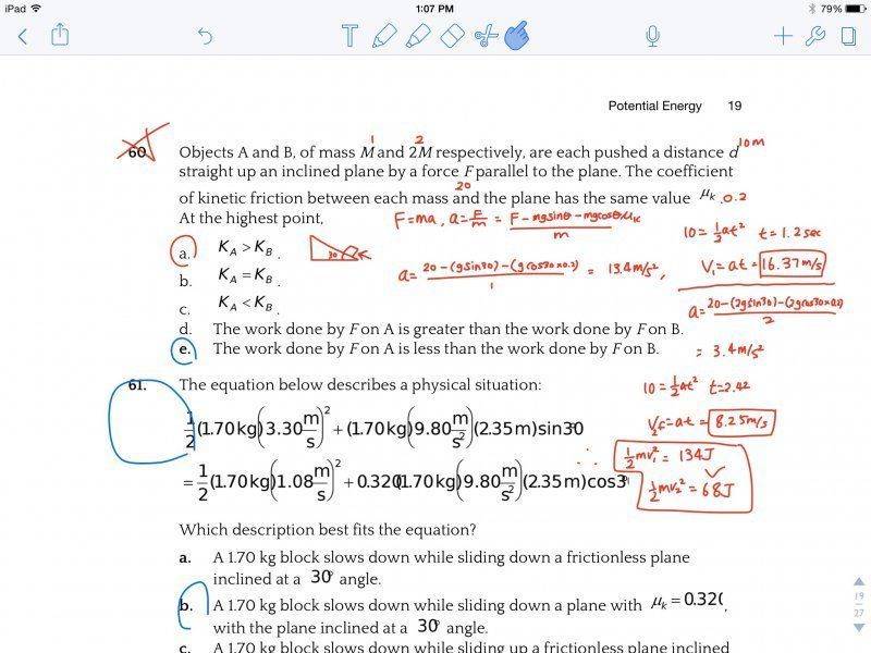

I kind of get a concept of this question. By using F=ma, it is obvious that mass M will have higher velocity than 2M when they move same distance because 2M will have lower acceleration. And since M has higher velocity, it might have higher K? I want to know how exactly Ka is bigger than Kb with solution, not just by a concept.

I attached my work. It's kinda messy, but can you check if my idea is right?? What I basically did was to put Mass as 1 and 2, distance as 10m, F as 20N, theta as 30 degrees, and kinetic friction as 0.2 and just solved the velocity of both and get the kinetic Energy of both...
looks good using that approach! Work energy approach might be simpler if you use it properly, but your method is fine. Note that you chose some good numbers, getting a positive acceleration up plane. Other number choices might result on no motion or motion down the plane, so be careful if your result came out negative. Did you check to see if choice d or e might also be correct?

I haven't checked it yet! I will do that now! Thanks
