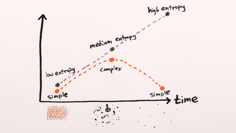

If the entropy of the universe always increases, how is it possible for organized systems like life to exist? Shouldn't the natural tendency always be toward disorder and chaos? I'm confused about how this law applies to biological systems.
The answer is illustrated by the following pictures:
Organized systems correspond to states with high complexity, where entropy is neither too big nor too small. See also the Appendix in my https://arxiv.org/abs/1703.08341
