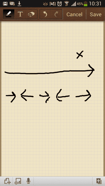

the particles are individual magnetic dipoles. they are arranged such they have alternating spins so they behave like bar magnets with same poles facing each other. The linearity of the force is only an approximation at small displacements from their eq. position
Ok, now I understand the arrangement, I see how you get the first order linearity.
Of course, each dipole has that sort of relationship to all the other dipoles, but it looks like this falls off as the inverse fifth power of distance, so maybe you only need consider adjacent ones.
Yes, that leads to the relationship you wrote in the OP, but I feel it would be more useful to write the right hand side as though n is a continuous variable. That should produce the usual wave equation.
What do you get for k in terms of the underlying constants (dipole strengths, spacing...)?
The physical embodiment of this arrangement still bothers me. What stops alternate dipoles flipping so that they all line up? What stops the whole chain expanding as the alternating dipoles repel each other? These considerations imply other forces, which would surely affect the wave behaviour.
