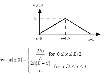

Hi,
I am working on some MATLAB for my engineering classes and I need help with understanding a given diagram.
In the attached diagram, I need help understanding how we determined the equations
For example, I would like to know the equations for a triangle with the peak at 2/3L
I know the equations would be from
0<=x<=2/3L
2/3L<=x<=L
but I need help creating the equations.
Thanks!
If you have two points on a straight line at (0,0) and (L/2,h) and you are asked to determine the equation of that line, do you know how to determine it, say, in slope-intercept form?
Same thing for the other line through the points (L/2,h) and (L,0).
Chet
Likes 1 person
Okay that makes sense, but when I solve like that I end up with a negative in the second equation and still not sure where the x comes in
m1=h/L/2 or 2h/L
m2=-h/L/2 or -2h/L
I apply that to my 2/3 triangle
m1=3h/2L
m2=-3h/L
both my m2's are negative but the given equation has the original m2 as positive.
btw thanks for the tip so far
EDIT:
actually give me a minute before you answer, i think I need to plug it into y=mx+b
So my actual problem has the triangle peak at 3/4L and the peak is represented by hplease verify my equations
slope 1 = 4h/3L
slope 2 = -4h/L
equation 1 = 4hx/3L
equation 2 = -4hx/L + 12h or (4h(3L-x))/L
Please verify I did it correctly
Thank you
slope 1 = 4h/3L
slope 2 = -4h/L
equation 1 = 4hx/3L
Thank you
You can verify it yourself. In eqn 2, if you substitute x = L, do you get y = 0?
Chet
