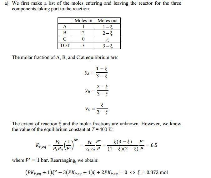

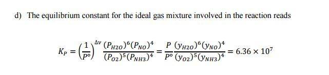

Kp,eq=Pproduct^stoichiometric/Preactant^stoichiometric=yproduct^stoichiometric/yreactant^stoichiometric
I did not understand why in question 1 why Kp,eq is done like that and why Psat(P) is underneath.
And why in question 2 Psat(P) is at the top in Kp,eq formula.
Why one time P is below and 1 time P is at the top in Kp,eq formula?

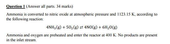

question2-sentence
https://www.physicsforums.com/attachments/105259

What is the change in the number of moles in the balanced equation for the first reaction?
What is the change in the number of moles in the balanced equation for the second reaction?

For the 1st reaction extent of reaction ξ=0.873 mol
For the 2nd reaction extent of reaction ξ=0.877 mol
Q1
Q1-Answer
Q2-
Q2-Answer

In problem 1, the give you the mole fractions of the 3 species in the final state. What are the partial pressures of these three species algebraically in terms of the total pressure P?

Okay. Now substitute this into the equation for ##K_p## (i.e., with ##K_p## is expressed in terms of partial pressures) for your A+B=C problem. What do you get? (And please use LaTex).

This applies to vapor-liquid equilibrium, not to chemical reactions. But, the y part is correct. What do you get when you substitute this for A, B, and C into the equilibrium relationship.

delta v = total number of moles of gases on product side - total number of moles of gases on the reactant side
like 2A(g)+B(g)---> 3C (g)
in this case products moles = 3
reactants = 3
delta v= 0
similarly it can be negative or positive
Remember mole is equal to volume if gases are at the same temp and pressure.
