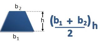

You really should learn the formula for calculating the area of a trapezoid:
It saves quite a bit of time. If b1 or b2 is zero, this formula reduces to that of finding the area of a triangle, A = (1/2)hb.
You should be aware that the load shown at point D is a 5 kN concentrated load. It is a separate load from the distributed load.
The value of the distributed load at point D is not 5 kN/m. The distributed loading changes by 4 kN/m over a distance of 7 m, so the value of the distributed loading at point D is calculated by linear interpolation. This step is unnecessary if you know how to calculate the area of a trapezoid, as shown above.

so the total forecs along y should be = 3(7) + 5 + 0.5(4)(7 ) ? , since you aid that 5N is concentrated load...
Yes, though I would have done it as 5+(3+4)(3+7)/2, the (3+7)/2 being the average spread load.
SteamKing mentioned the 5kNm torque, but since that is a pure torque it does not feature in the net force expressions.
