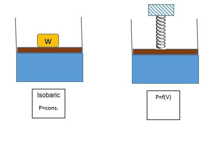

If rubber tension is negligible it is isobaric otherwise we can consider P=f(V), and f depend on rubber specification and balloon dimensions.
https://physicsforums-bernhardtmediall.netdna-ssl.com/data/attachments/59/59222-ef0af70f5c70ec1351bf0a5e6d506887.jpg I
Actually, it would be the pressure difference across the rubber membrane ΔP that you can calculate from the rubber properties and the balloon shape.
