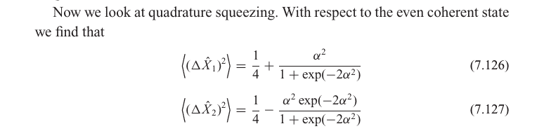

I need to derive the equations 7.126 and 7.127(image posted) from Gerry/Knight's quantum optics book. The equations are the expectation values of the square of the quadrature operators for the even cat state.
<X1^2>=0.25 + ( (alpha)^2 )/(1+exp(-2alpha^2))
<X2^2>=0.25 - (exp(-2alpha^2)*(alpha)^2)/(1+exp(-2alpha^2))
I started and successfully showed that the expectation of X_1 and X_2 are zero. However the expectation value of X1^2 and X2^2 which I am getting is <X1^2> = 0.25 + \alpha^2 and <X2^2> = 0.25.
How do I derive the given equations?
