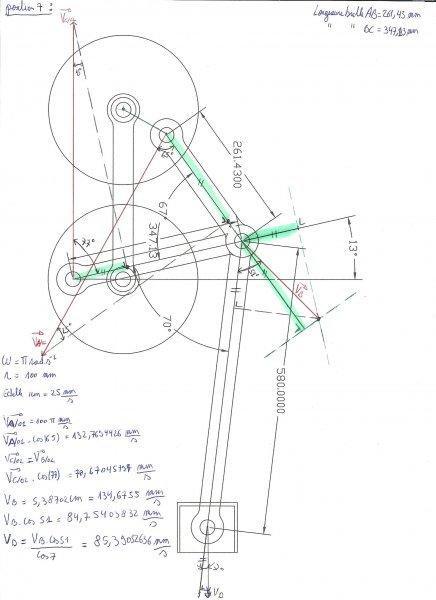

Hello,
l need to find the acceleration in the D point but i don't know how.
the 2 circles turn in the same speed ( pi rad/s).
I use a simulation programme to find the D acceleration ( - 1643 mm/s^2) but how to find it with a mathematical approach ?
Sorry for my english
  • Handwritten kinematic diagram of a slider-crank linkage with two rotating circles, green-highlighted links, dimensions such as 261.4, 300 and 508, and velocity vector annotations with calculations below.
I don't understand what is fixed to what and I don't see point D.
Anyway: introduce variables for relevant positions, express your constraints (distances, angles, ...) in terms of those variables, solve the resulting equation system for the position of D. If that turns out to be impossible analytically, use numeric solutions.
