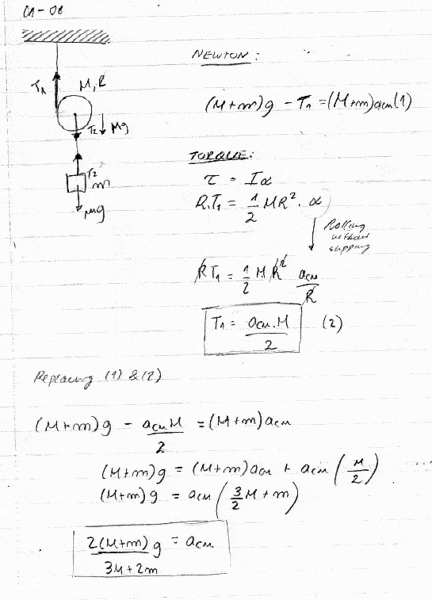

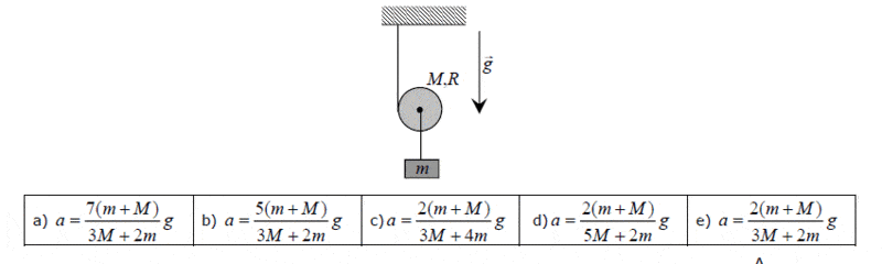

I have that system and the problem says:
A disk of mass M and radious R are posed are shown. The disk is hanging by an ideal rope which is coiled up. From a smooth axis through the center of the disk is haning a body m. Calclate the module of the aceleration of the center of mass of the disk.
I've done this excercise but without the small mass hanging there. What I did was to use the torque and Newton formulas, that simple. But here I've got two bodies and tensions are driving me crazy. Should I consider the bodies as a single one?
Thanks!

Hi Hernaner28! :smile:
Yes, since they're moving together, you can regard them as a single body …
add the m to the mass of the pulley, but not to its moment of inertia. :wink:
Done! Thank you!
yes! :smile:
here's a shortcut (i don't know whether your professor would approve of this, but it's certainly a good way of checking the answer) …
the force is (M+m)g, and the effective mass is the actual mass M+m plus the "rolling mass" I/r2 = M/2,
so a = (M + m)/(3M/2 + m) :wink:
