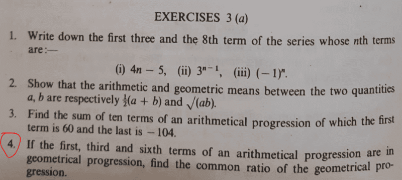

If the first, third and sixth term of an arithmetical progression are in geometrical progression, find the common ratio of the geometrical progression.
geometric mean
My attempt;
The terms in the arithmetic sequence are ;##[ a, a+2d,a+5d]##.
It follows that;
Common ratio ##r=\dfrac{a+2d}{a}=\dfrac{a+5d}{a+2d}##
##⇒ar+2rd=a+2d+3d##
##ar+2rd=ar+3d##
##ar+2rd-ar=3d##
##2rd=3d##
##r=\dfrac{3d}{2d}=\dfrac{3}{2}##

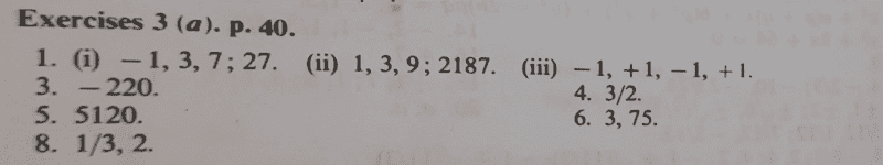

The solution given on the textbook is ##r=\dfrac{3}{2}##. Seeking alternative method guys.

Your textbook is wrong. If a=0 then the sequence is 0,0,0,0,0,0 and the common ratio is undefined. If a is not 0, then the common ratio is either 1 or 3/2. You missed the r=1 solution because you divided. Instead, multiply, using the fact that each term in a geometric sequence is equal to the product of the adjacent terms.

First, a is the starting value of the sequence. If a = 0, then the arithmetic sequence is {0, d, 2d, 3d, ...}. This sequence is the zero sequence only if the common difference d happens also to be 0.
Second, each term in a geometric sequence is equal to the product of the common ratio and the previous term, not the product of the adjacent terms.
Finally, from the equation ##r = \frac{a + 2d}a##, and assuming ##a \ne 0##, we get ##ra = a + 2d## or ##a(r - 1) = 2d##. If r = 1 as you said, then d = 0 as well, making the arithmetic sequence {a, a, a, ...}, not a very interesting arithmetic or geometric sequence. Perhaps the textbook had additional constraints that weren't included in the problem statement here.

I may not have an immediate answer @Mark44 ...the purpose of me sharing the questions is to enjoy the beauty of maths with the viewers, more so getting diverse opinion on a subject matter...I guess I mentioned that in the past.
The textbook has no additional constraints...the problem set here is word- word as it is on the text.
