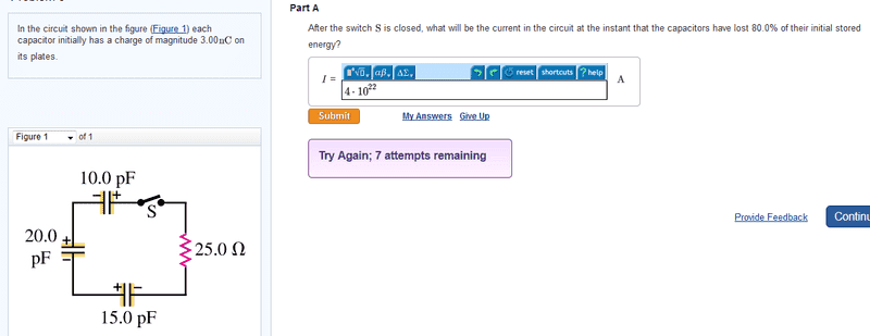

In the circuit shown in the figure each capacitor initially has a charge of magnitude 3.00nC on its plates.
A) After the switch S is closed, what will be the current in the circuit at the instant that the capacitors have lost 80.0% of their initial stored energy?
Image attached
C=Q/V
V-IR
Knowing that V = Q/C I tried to calculate the voltage
V = (3x10-9C)(1/15x10-12F + 1/20x10-12F + 1/10x10-12F)
V = 1x1024
Then using V=IR
I = V/R
I got 4x1022
It says this is wrong and I'm not sure what else to try. Help would be appreciated.
Your calculated voltage looks awfully high. Better check your arithmetic.
I don't see where you've accounted for the 80% drop in energy.
