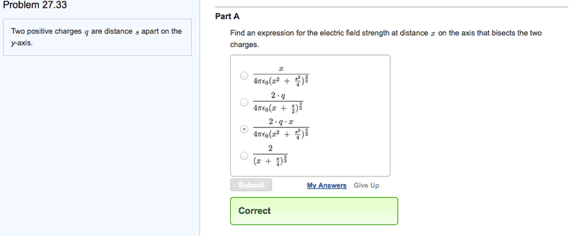

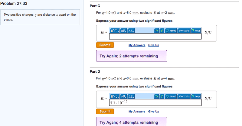

I have tried parts C and D several times, and the homework program is telling me that it's still not correct. For C, I keep getting:
7.7x10^8 N/C
for D I keep getting:
7.1x10^-12 N/C
In order to find these, I know you just plug in the known values into the equation from part A. But each time I plug these in, I get an incorrect answer. Please help. Thanks in advance!

rocapp said:
See images
See images
7.7x10^8 N/C
7.1x10^-12 N/C
For parts C & D please show your work, i.e. show exactly what numbers you are putting into your formula.
You are using millimeters and nanoCoulombs, aren't you ?
Oh! Units were the problem. Does this change the value of the permittivity constant from 8.85x10^-12 F/m to 8.85x10^-9 F/mm?
That is correct. I fixed the problems. Thanks!
