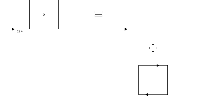

I suggest doing a web search on the magnetic field due to a finite current carrying wire segment. Of particular interest might be the field along the perpendicular bisector of such a wire segment.
Alteratively, would this figure be a hint ?

Does it result 6.3*10^-5 T using this method (because we haven't learned L yet)
Could you explain something more?
If you can find the field at O for the two parts on the right, all you have to do is add them up to get the field from the one part on the left.
And be sure to follow Gneill's advice: your relevant equation is for an infinitely long wire, so Ok for the lower part on the right. But not for the upper part.
